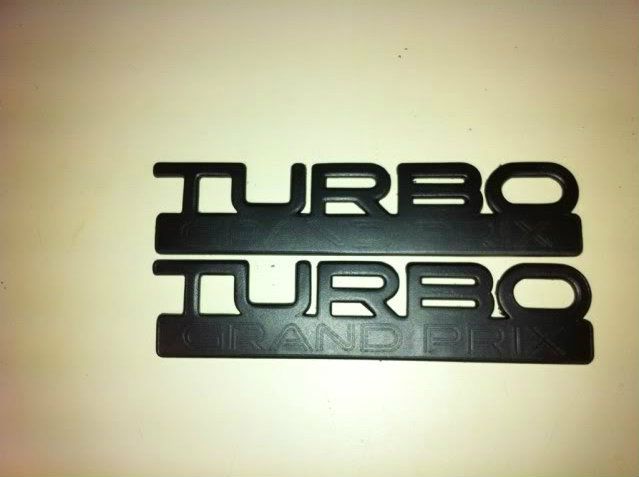

    Thanks guys it's a work in progress. Slowly getting to where I want it.
    Just laid down some plasti dip on the turbo emblems. I'll have pics up in afterwhile.

  3. #3 Re: txslow6's 97 TGTP----> OEM turbo badges getting plastidip
