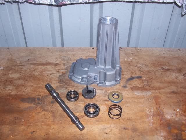

    I have already disembled my spare snout and intend to swap the shaft into my already polished snout housing once the bearings have been replaced ,I used a 3 claw puller to get the coupler gear off and a long piece of steel tube and a hammer to drive off the rear bearing (the rest is covered in the how to on the net at this stage )

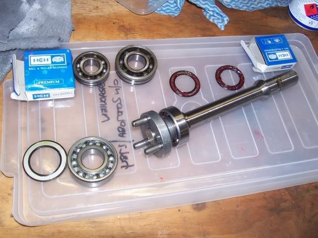

    Bearing numbers are 6203 & 6204(i think they are the same numbers of the idler bearings but are unsealed ) Im going to ring around to see if they are aviable locally or I have to order them in from the states
    I bought the bearings today they cost about $7 each and are the same numbers as the idler pully bearings except without the seal
    parts numbers are front 6204 and rear 6203 they must be rated for a C3 fit & 18000 rpm (I found this info on the net)
    After ringing 4 bearing shops the only bearings they had in this size had seals ,they said this was the only difference between them and to remove the seals to allow oil to pass through them
    using a sockets and a rubber mallet I carefully assembled the rear bearing & drive onthe shaft keeping in mind about the spline and checking everything is square (I know I should use a press )

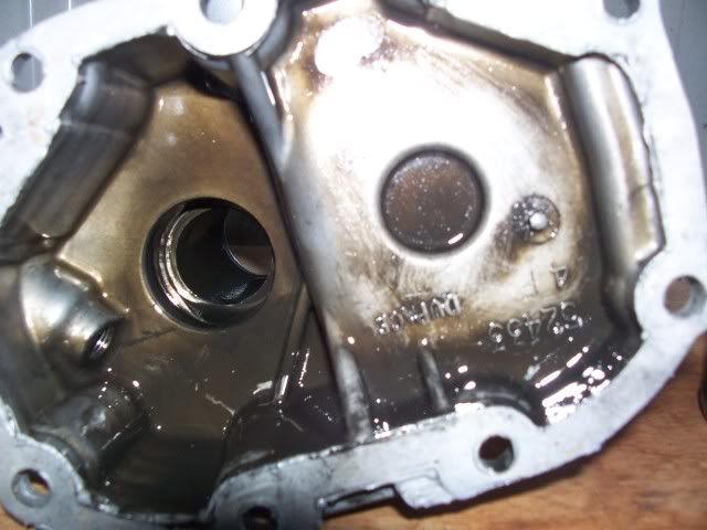

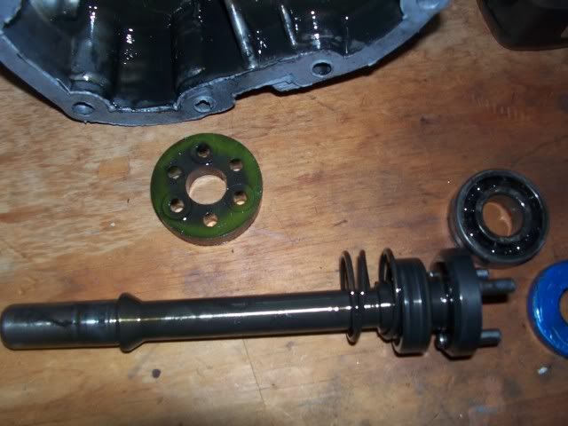

    I removed my snout today and the oil was filthy lots of sooty looking particles even though I only replaced it a couple of months ago when I swapped the supercharger & coupler over I think it got so bad because of the coating of sludge in the housing and rotor packs that doesnt come out when you drain the oil ,both bearings had a lot of slop in the them and feel very gritty to turn

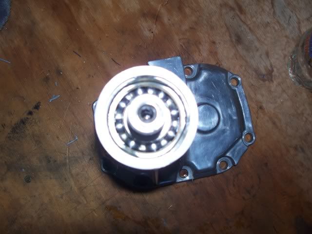

    So after a good clean of the snout housing with the bearings removed ,I put the new front bearing into the housing and put the shaft in once again using sockets ,this was a bit tricky seating the bearing because the shaft is spring loaded so its best to take some measurements of the shaft in relation to the housing while everything is still assembled
    Them I gave things a spin looking at different angles for any wobbles at both ends
