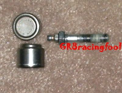

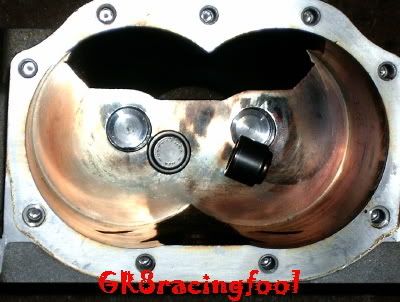

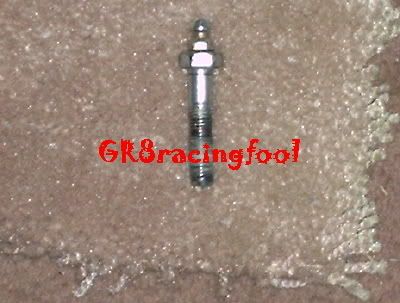

    Here is my tool I made many-many years ago.
    For a quick slap together prototype, its still working flawless today.
    Hope that helps you some.
    ~F~
