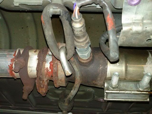

    Take a spark plug non fouler 42002 i think the part number is. Drill a 1/2 threw one then take your o2 sensor and put it in that one and then take that and screw it into the other, then just put it in the bung. No codes.
    Like so

  5. #5 Re: What Is The Best Resonably Priced O2 Sensors and Catalytic Converters
    16,085
    ^ bingo... Worked for me for awhile until I had the codes tuned out. Grab a downpipe with hi flo cat from ZZP install it yourself.. Then if you get the p0420 code throw in a spark plug fouler and enjoy the added performance.
