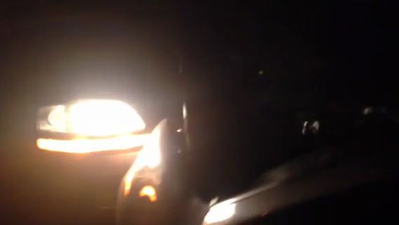

    Just picked it up. Broken, won't start, doesn't sound electrical. It like it tries to start then dies.
