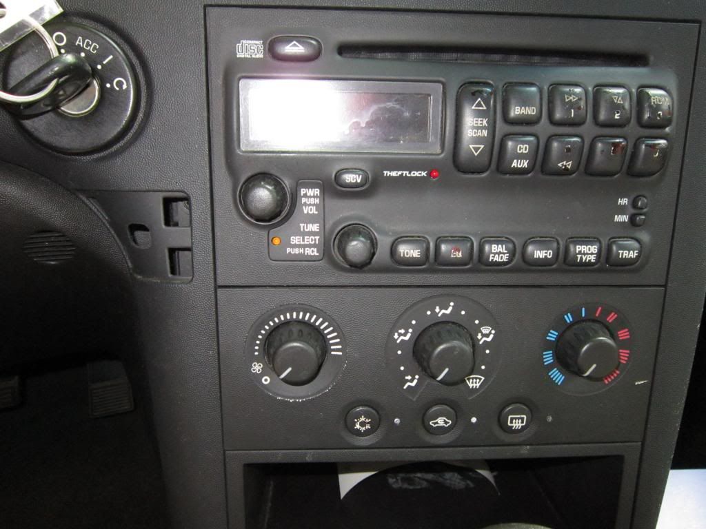

    Fourth: a piece seems to be missing from the console under the key slot and next to volume knob:
    http://i256.photobucket.com/albums/h...ps0f9bd507.jpg
    What is it? So that I can look it up and get it to cover the unsightly holes.

    The missing part on your dash is a little textured pad. I can only guess its purpose is to keep your keys from making a bunch of noise when swinging back and forth and hitting the dash while in motion.

    I can probably trim a piece of thin black foam and hot glue it in place.

    The piece that is missing is this GM# 15238632 - List $7.29
    If you have any questions about part numbers that you can't seem to find, PM TLSheff, he works at a dealership in the service department.
