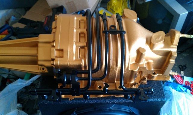

    Just picked up an 02 GTP 40th anniversary Coupe with 160k km's on it. Only aftermarket part is a K&N cold air kit, however it also the includes the ever popular "dreaded" leaking intake option.
    Got it for a deal because of the intake leak. (no milkshaking in the oil either) I've done the repair 3 or 4 times so it shouldn't be an issue. Just wondering what everyone else would replace while were opening her up.
    My list is as follows.
    -Lower intake manifold gasket
    -Injector O-rings
    -Supercharger (upper) manifold gasket
    -Supercharger oil
    -Valve cover gaskets
    -both coolant elbows
    -lower temp thermostat
    -Spark plugs
    Anything else while were down there? Thanks guys
