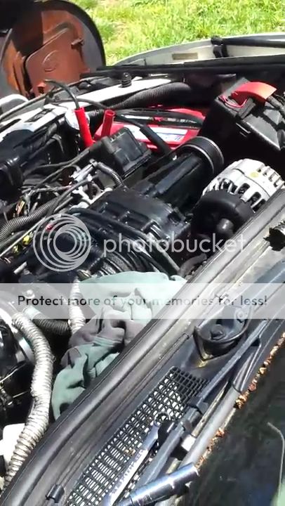

Well the motor is in and it fired up!!!!! But it's idling at like 1100 - 1200 RPM, I think I have my vacuum routing wrong. Well I know I do, I have my FPR only seeing vacuum so it's probably causing a problem. I need to redo it, will today. And my battery took a poop, won't hold a charge and is hissing at me. Looks like I gotta get a new one of those to. BUT other then that all sounds good when it ran, just couldn't hear the cam with it reved..I'll tinker with it again today. One other issue is my N* cable, I gotta do some tweeking with it. I have the bracket, but it's still not right. installed it pulles on the linkage opening the butterfly some. Small things I hope!!!! But here's pics..
****LAST PIC OF THE "MOTOR" IS A VIDEO****
Your butterfly on the tb being open a little will cause the higher idle.
Yep, that's why I haven't hooked it up yet.. LOL Well, I did hook the pedal cable up and saw it was causing the issue, so I unhooked it before I went to start the car. It's an issue I have to fix.
I think the idle is from my FPR. I have it hooked up like my L36 was... (yeah I'm a dumbazz) so it's not seeing boost. I'm about to go out and reroute the vacuum lines to end the vacuum only at the BBV and run the FPR off the nipple on the LIM.
