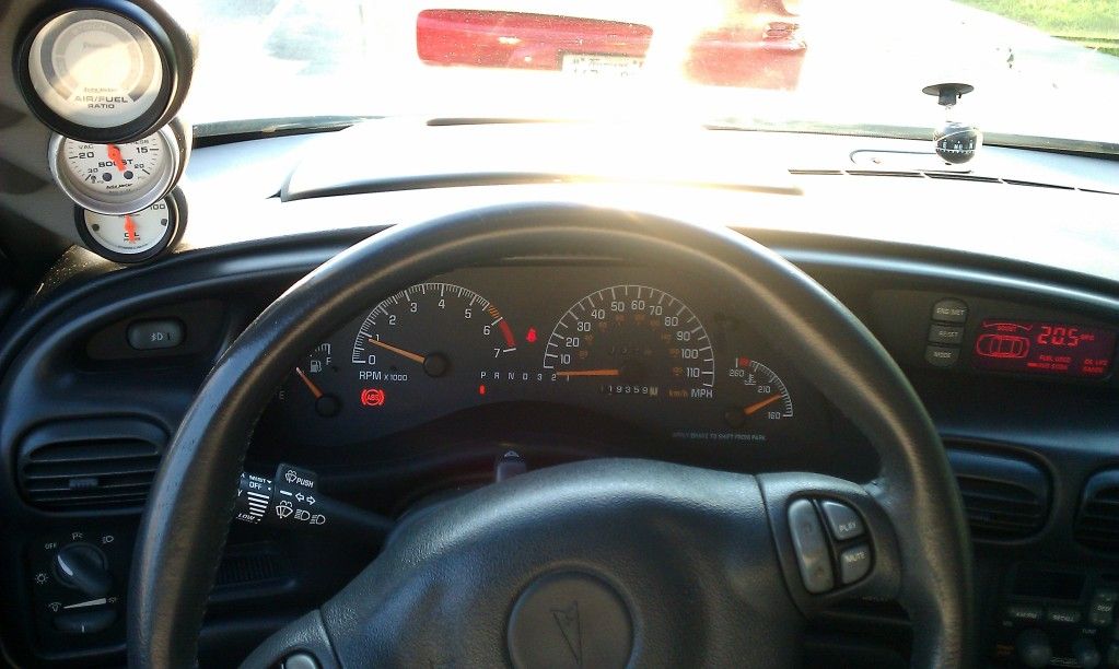

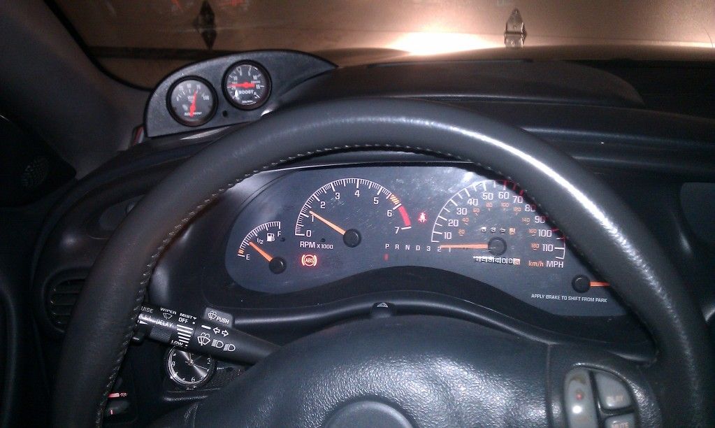

    Just an update. & to say, THANKS AGAIN.
    Breaking my oil pressure sending unit, ~$40, spurned me into replacing PO's guages to something closer to my personal pref. PFYC.com Z series autometer. The font does not match, but IMHO the colors work much better. I'll probably spring $25 for the amber LEDs before I'm thru. & I'm glad to NOT to have the LED flashing light show in my face anymore. All in all, I'm real happy I finally got this off my to do list.
    New b/v guage was bouncing and sticking. I found a tip on "proper" place to T into b/v line for guage, moved T from under snout to end of line on the back side and ran the new nylon tubing that came with new guage. Works great now!
    A few pics, before and after.
    My ABS & TCS OFF lights are like old friends now.
