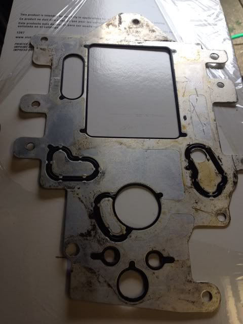

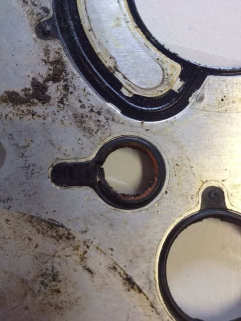

    I replaced the gasket between the supercharger and manifold. The coolant portion had damage. After refilling coolant im still having to add a splash every other day and don't see a leak anywhere. Also if it needs coolant isn't it suppose to take from the reserve tank? Mine never has. Tank will be at full line and radiator empty... (while I was at it I clean the crap out of the supercharger and manifold and it's amazing!!!!)
