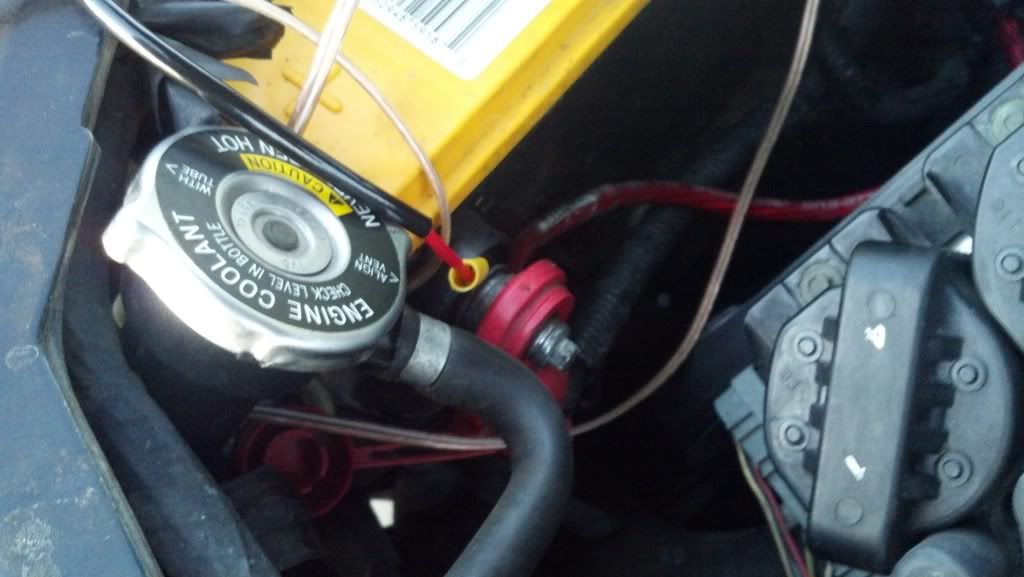

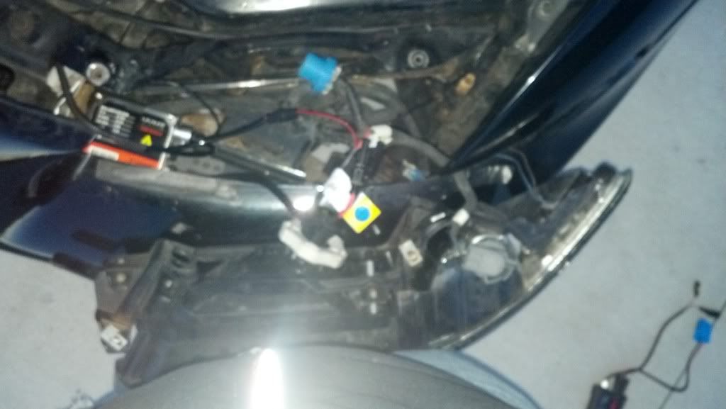

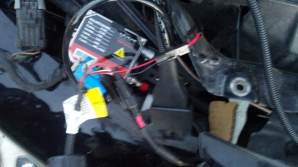

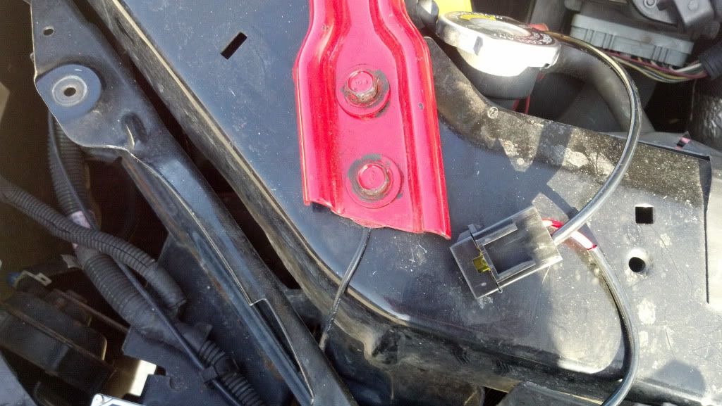

    So i ended up buying VVME Bi-Xenon Headlights and Foglights. As i hooked them up the way i suppose to (well obviously not cause they arent working) but the lights turn on like normal but when i use my Hi-Beams nothing happens at all, no Hi-Beams the 2 ground wires from the H.i.D kit are connected to the battery and the one positive wire is to the battery too. Also, neither of my foglights will work because i think the car thinks that my Hi-Beams are always on (the Hi-Beams light on the dash and heads up display is always on). What did i do wrong? can anyone help? or did i just waste my money and should just go buy regular H.i.D's from VVME?
    I originally put one ground here

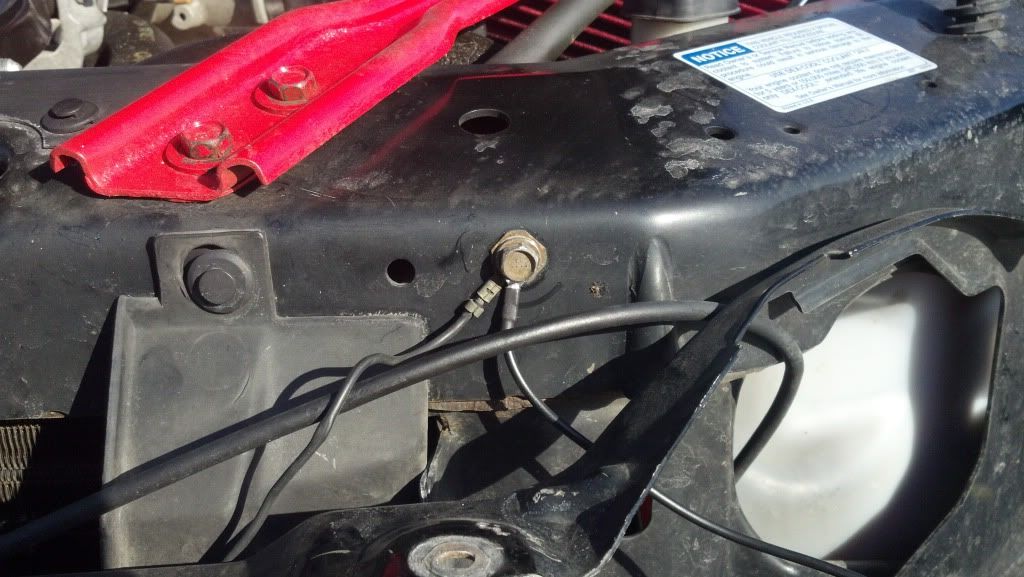

    And the other ground here, but now they are both connected to the battery.

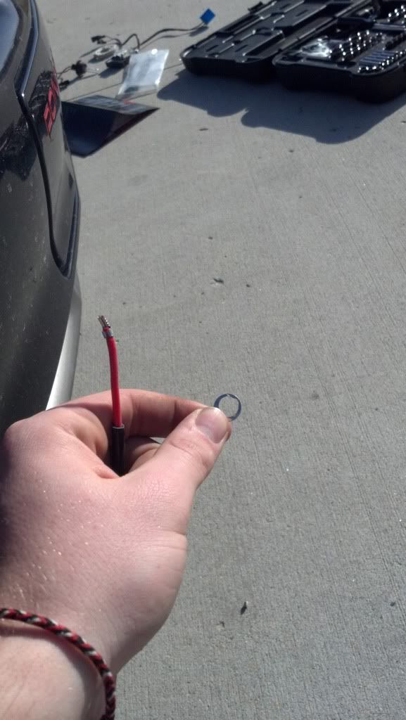

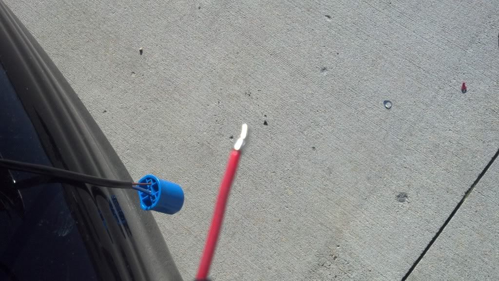

    The positive wire from the H.i.Ds wasnt big enough to fit over the battery bolt so i bought new connectors.
    Extended the ground wires and put them to the battery

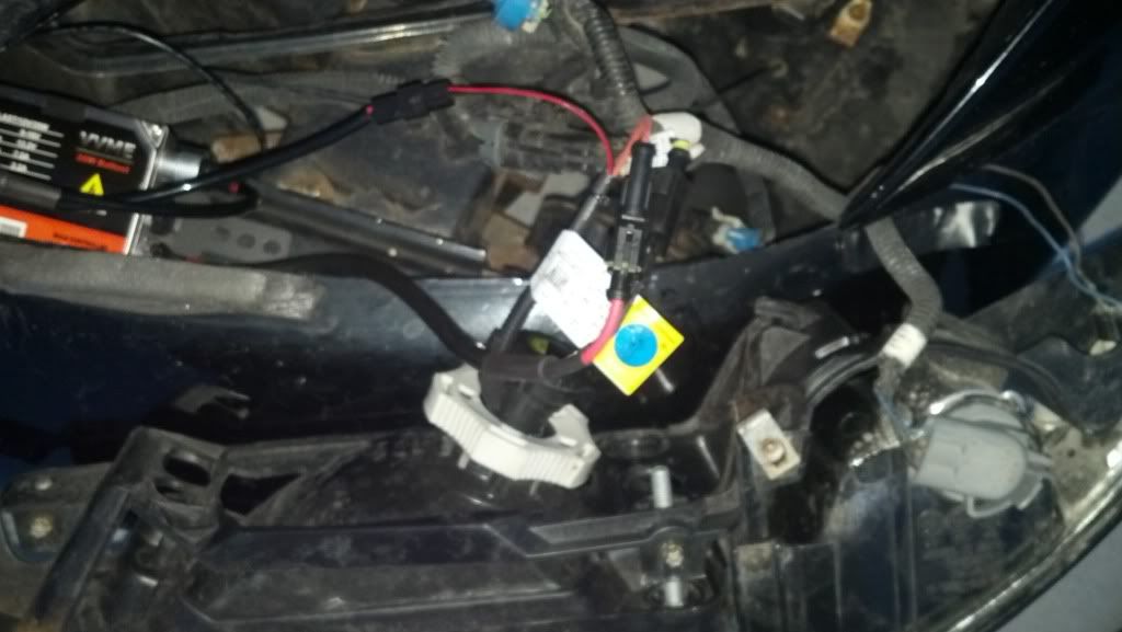

    Positive wire

    9007 kits usually have the low.and high beam leads flipped. At least mine was when I did.the ram. And it was from vvme as well.

    Cobalt guys have changed the order of the wiring to the blue headlight plug, with the 3 wires...I had to try a few different ways to get DDM's kit to work the correct way.

    I'll try that when I get home. The 3 wires are already "locked" into place in the blue holder, can I still remove them without breaking it?
  6. #6 Re: Bi-Xenon VVME Help
    I think you need to lay it all out and take a picture of it...that way I can see if it is the same kit I had to install or not. If it is, then it be EZ PZ

    I did what you told me, I switched the wires around in that blue connector and after a few tries i got them work, such a relief. thanks for the help blue
