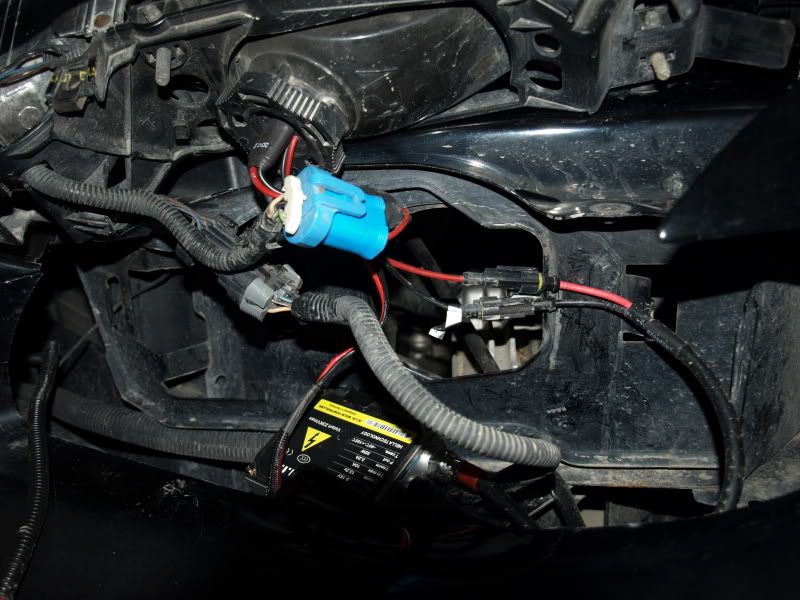

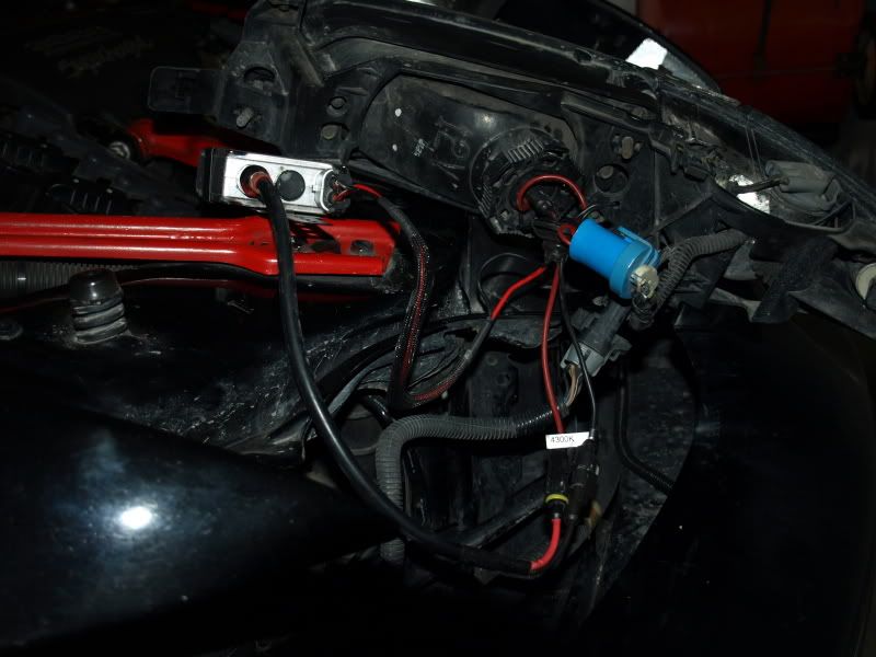

Ok cool, I ordered the Relay and tried to install it. HA installed, tested the lights. To my dismay they won't turn on.
I can get pictures if needed but for the life of me i can't figure out what i'm doing wrong.

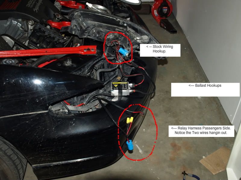

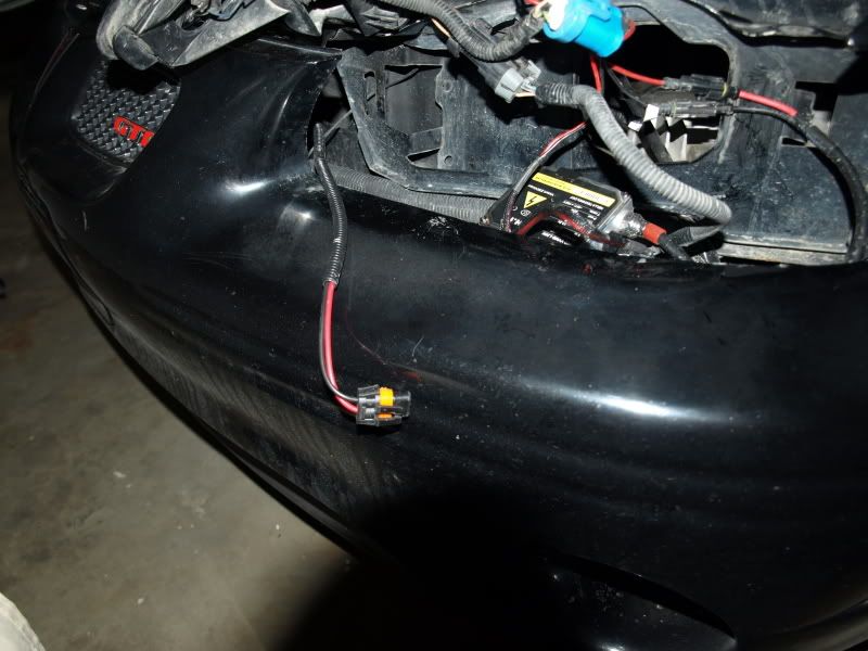

I hooked the relay ballast power to the ballast and disconnected the ones it was currently using from the stock wiring. Then i wired and grounded the relay. This relay kit has a plug like it hooks into the stock wiring to get a signal at the passengers side bulb vs the stock wiring plug going into the bulb like before. One thing that does baffle me is it had two little pigtale wires hanging out the back.
I've heard you have to plug these into the stock wiring or splice into it to get the signal to the ballasts. SO i touch the wires to the bulb conncector and it lights up but only one side..... So i'm thinking i need to hook the stock plug back in and disregard the blue plug from the relay and splice the pigtails into the wires that send the signal to my ballasts ???
Any insight would be great people. For i am a lost soul in the world of HIDS. Like i said i can get pictures if needed.
