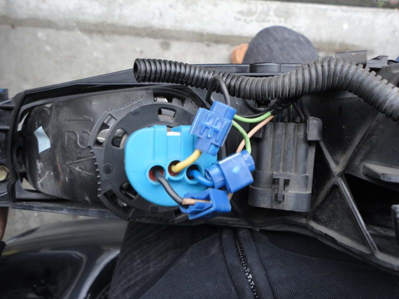

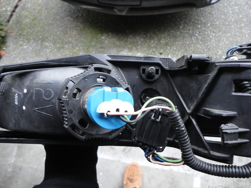

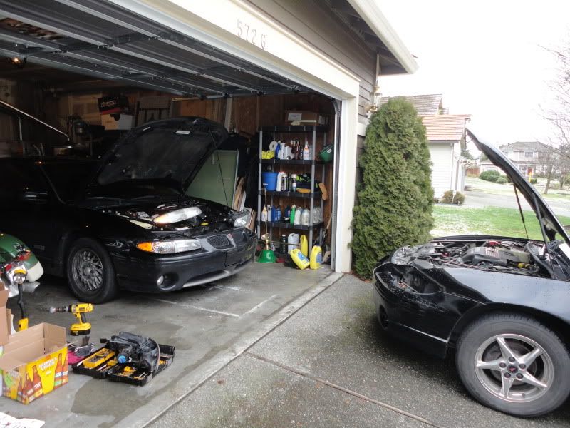

    My two GTPs thank god for having spare parts
    The Ghetto hacked wireharness
    The way the stock ones that work look, and should look
    So I isolated the issue. The previous owner must have ghetto hacked some HIDs or something cause I swapped out my 01 lights with the malfunctioning 97 and they worked just fine. So for now I have disconnected the head lights and that freed up my fogs so that I have at least some lighting forward. All of the forward lights must be connected somehow?
