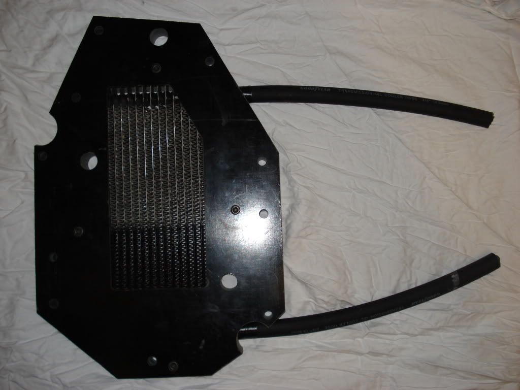

    I'm looking for a few tips before installing my ZZP SSIC. Please no comments about wasting time on the SS. I got the flojet pump and the largest radiator ZZP offered. If anyone wants to help, I'm in the NW burbs of Chicago. Will offer food/booze. Thanks!

    Good buy for sure. I would say routing and installing the pump and hoses would be the hardest part if there are no detailed instructions...

    Cool. I was mostly worried about getting a good seal around the ic and ic core. The instructions don't look all that great and I can't seem to find the cd that came with it either

    the hardest parts to install are the front mount heat exchanger and the pump. it would also be a good idea to have a nice overflow for easy addition of more coolant, ice, and easy bleeding of the system.

    yea, you have to shim the coil packs up like 1/2 ", not too hard. Otherwise the belt will hit it.

    Yep, Most just use a nut in between the coil packs and bracket.
    Make sure you determine what kind of pcv functioning the ic has. You may need to run a breather or you may not, not sure on ssic. The other part is trying to get the air out of the system using the SSIC. The way the hoses are routed it is hard to get a high point in the system to mount a reservoir. You can try and run your return line back towards the wheel well in the engine bay (a higher mountable point) and mount a T fitting with a 5 psi. cap on it to bleed the system of air.
    Also which fmhe did you get? One of the largest ones is for those who have deleted a/c. Or the newest style?
    If your thinking about upgrading to a full size later on, you may want to get all your hosing and heat exchangers in order now so it is easy to upgrade in the future. If you really wanted to, you could put a pcv pipe through the front bumper supports and put fittings on there to route water through there before it even gets to the heat exchanger, and add a lot to your systems capacity. But theres only so much you can do before the SSIC plate just gets too small to do the job.

    ssic uses stock pcv in every way

    As long as you have the channel added to the LIM, right?
