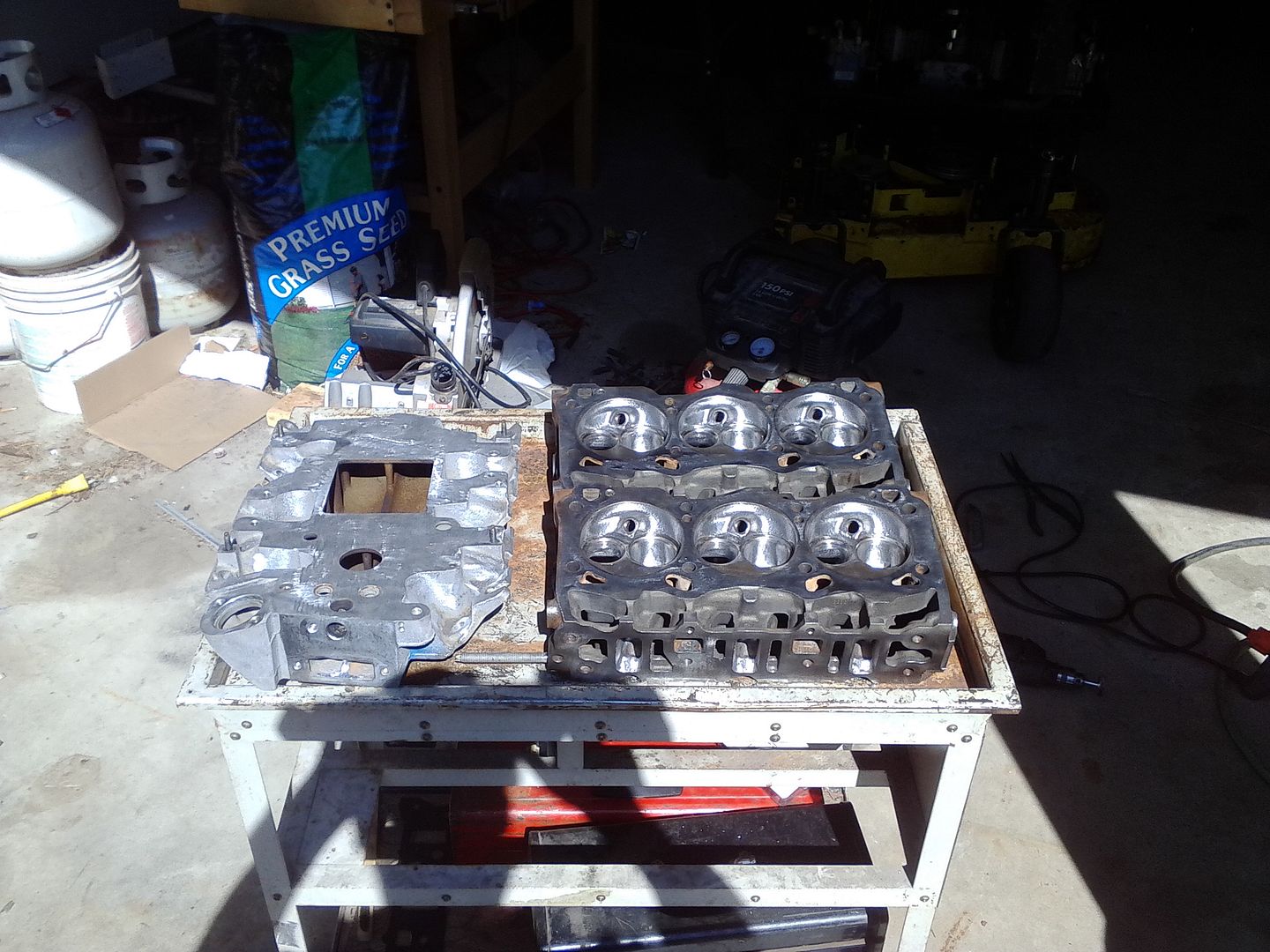

    it cost me about a 100 bucks in tools to diy port and polish my heads. i lapped the valves and put em back together. if you got the time to invest doing the work its worth it. it took me a good 20 hours in all. maybe a bit more. did 2 to 4 hour working shifts on em over a few weeks time.
    exhaust, not even polished yet.
    factory casting crap that you clean up and smooth out.

    Dang Scotty. That port job looks great. You guys are temping me now
