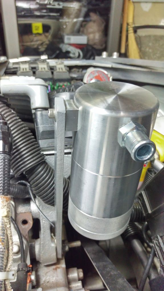

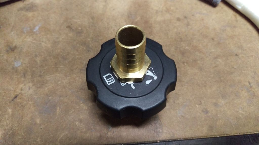

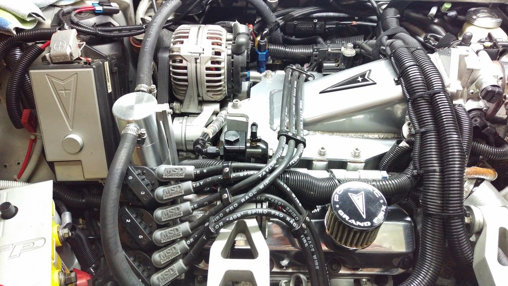

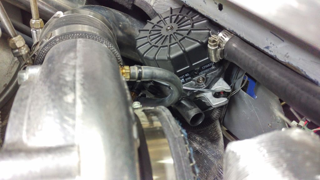

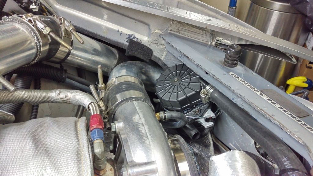

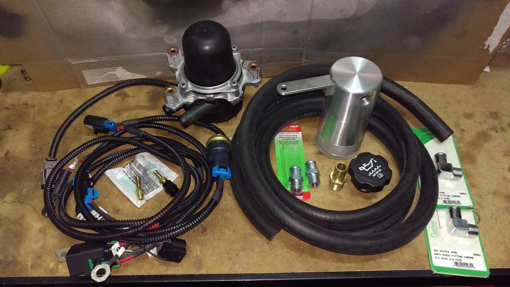

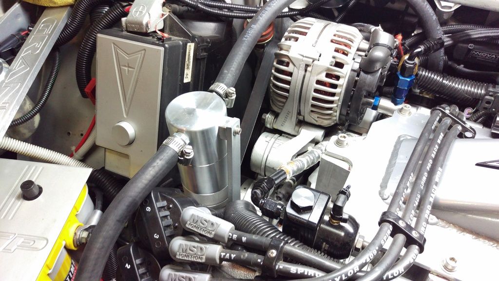

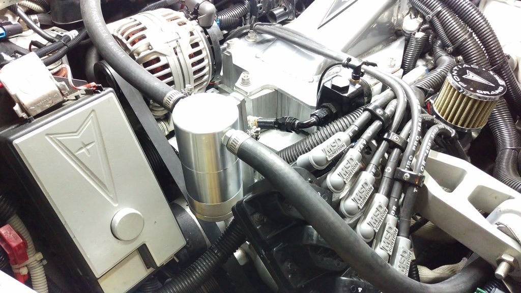

    Catch can and vac pump are installed. Still waiting to test it out.
    The vac pump is on a hobb switch so it will only come on when in boost. This will help relieve the crank pressure and blow by I'm getting which I think is the reason for my misfire at high boost and rpm.
    Going to put thermo wrap around pump to keep heat from turbo away from it.
