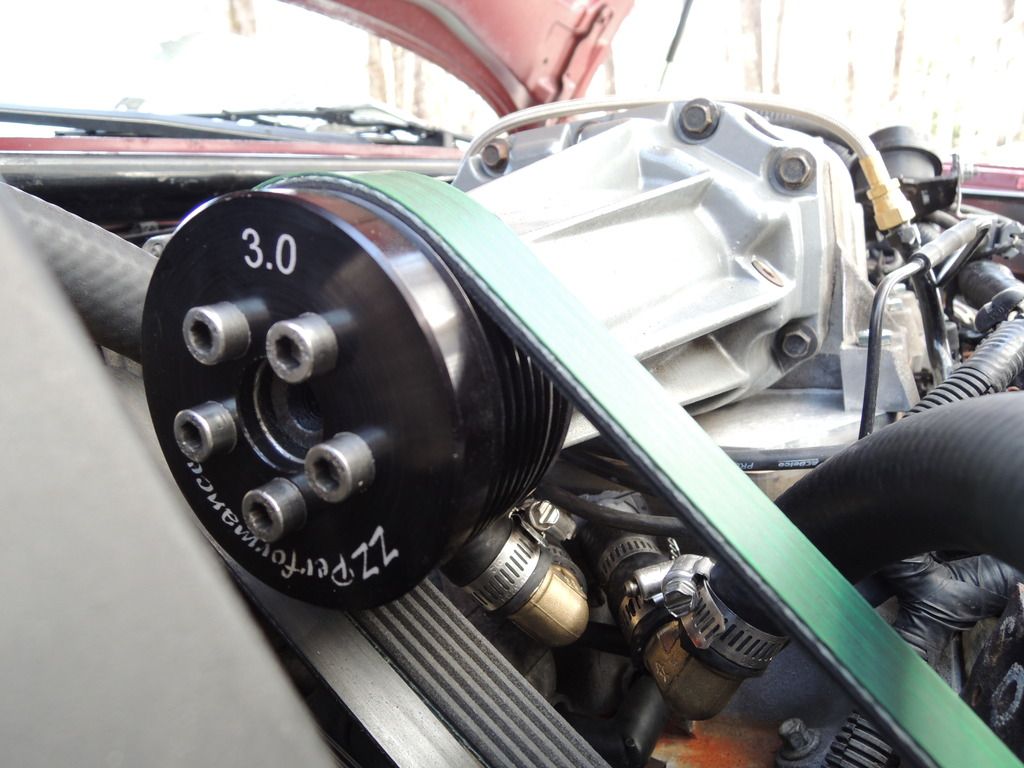

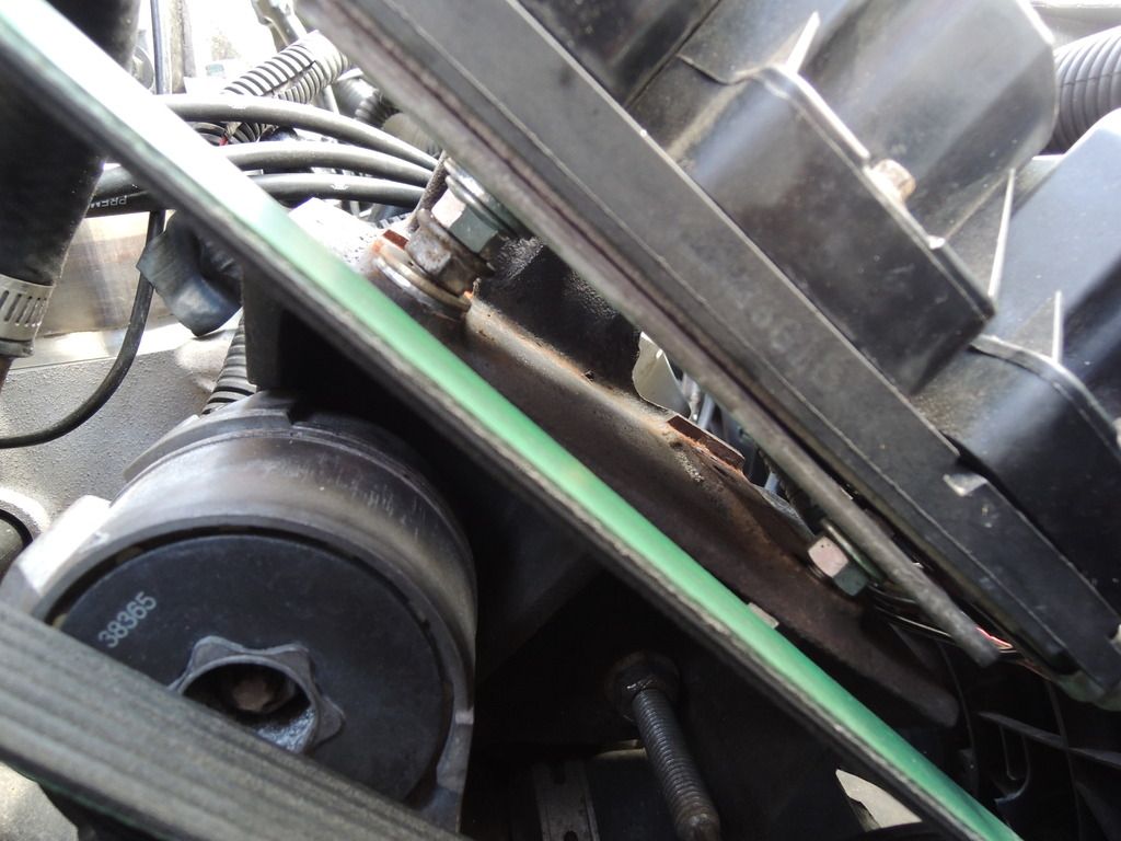

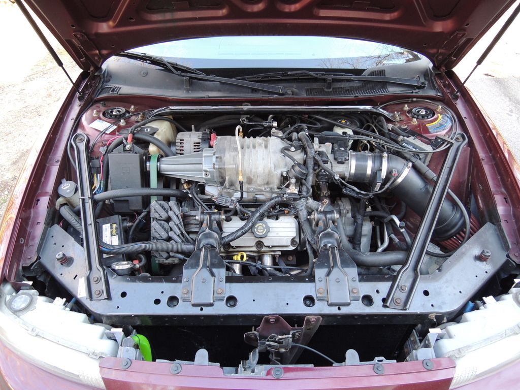

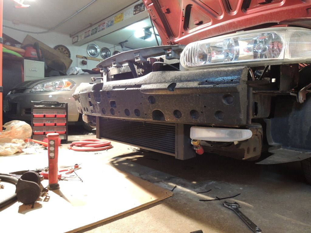

    Recently installed my Phenolic IC along with W-Body Store/ZZP FMHE. I'm pretty sure every one has their fluid lines routing the same way but I will double check here.
    As you see the outlet line (red) goes to the bottom of the IC pump.
    It then comes out the side of the pump to the IC core (most rearward line by alt)
    The line by the coil packs then goes down to the inlet of the FMHE by the passenger fog lamp.
    Seem correct?
    When I added fluid the pump was very quiet! Then out of no where it was screeming!!!!
    I popped the inlet line off at the FMHE (by passenger fog lamp) and ALOT of air came out and then the pump got quiet again.
    Added more fluid, cycled the pump a few times and no more bubbles were seen at my fill tube.
    Biggest question I have...?
    MUST I drop the pump down more to prevent any air? Or prolong the pump's life? It is hard to tell (in the driveway picture) but I relocated my horns to the cradle area by the passenger front tow hook.
