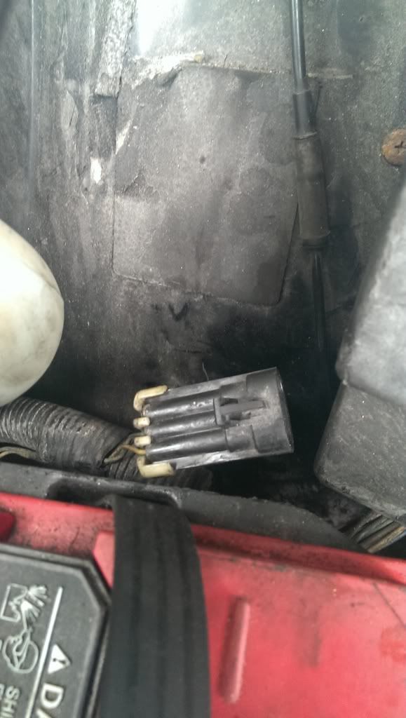

    Ok after further inspection I noticed two connectors on the passenger side of the engine by the battery. Kinda close where my old overflow bottle used to be. I can get pics when I get off but does anyone have any idea what it could be?

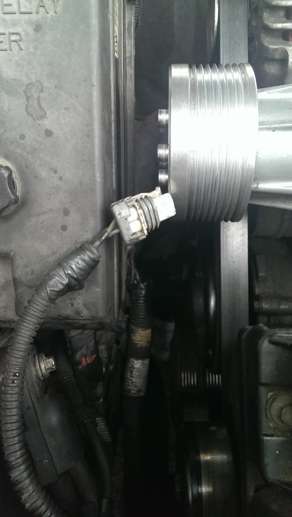

    These are the two connectors

    The second pic, does that harness have slack?

    Yes the harness has slack I'm going to go back and check in a second. The part of the exhaust that is not hooked up is where the downpipe meets the rear manifold. We had lost the bolts during the transfer and I'm going to hit a shop to have to put on right quick

    That fast I found the connectors. Apparently on the driver's side the same Connectors Are there and hooked up. So my question is, where did the extra connections come from
    Sent from my HTC One using Tapatalk 2

    They are back kinda by the battery in the same harness as the window washer pump right? From what I have been told those are for the digital climate control.

    Makes perfect sense because I used to have digital climate on the other car and this one is don't.

    Yeah both my cars have those 2 wires and neither of them are hooked up to anything.

    That 4 plug harness looks like the one that should be on the front side of the engine between the fuel rail/front valve cover. The second plug looks like the coolant temp sensor plug. Are you sure you have your wiring harness laid out correctly?
