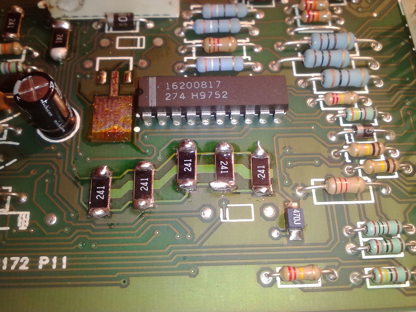

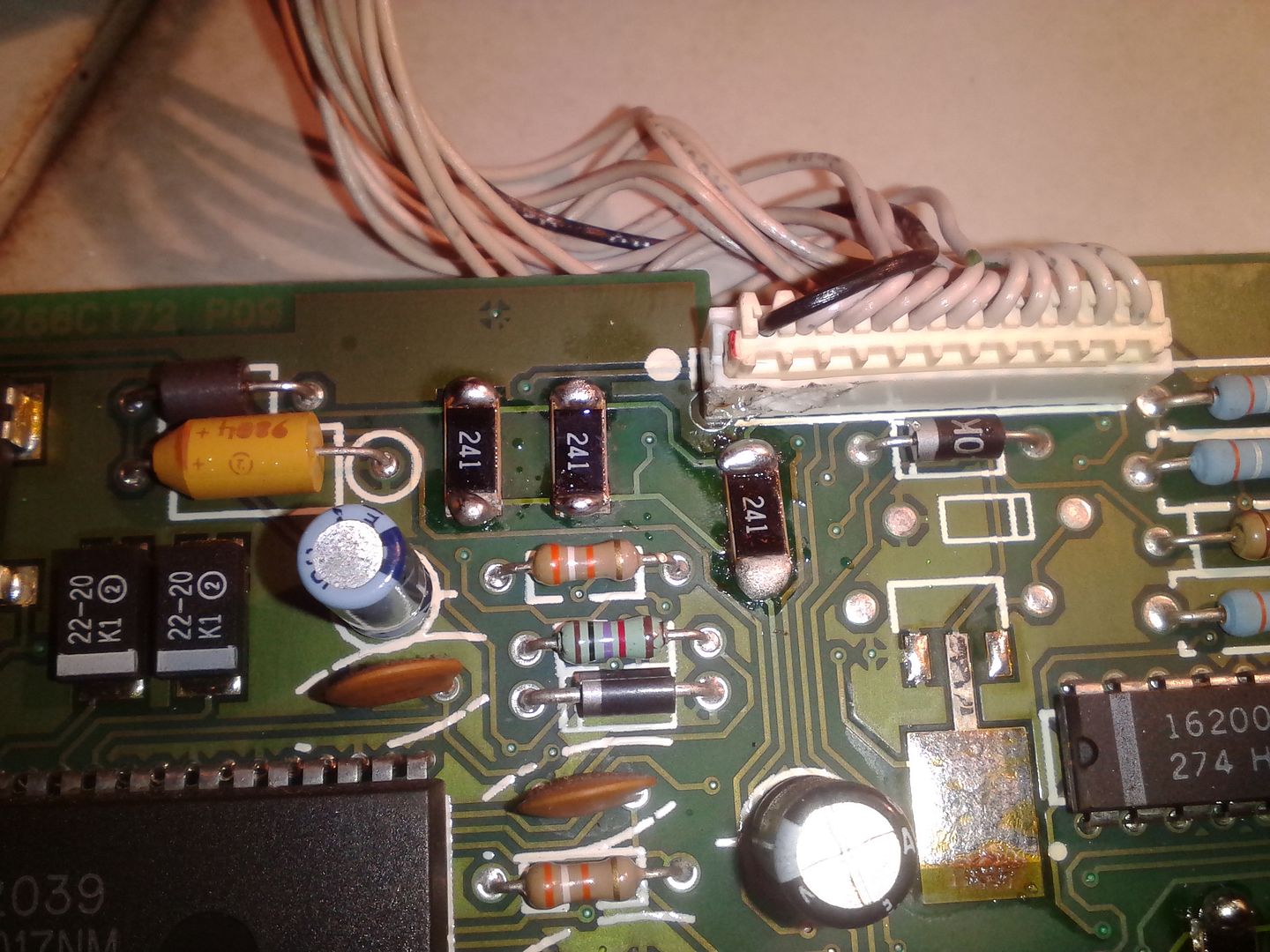

    took my climate control out due to it lighting up when ever it wants to. re soldered all the little chips on the board, funny as i heated up one side they all came free, so none of them were stuck all that well.
    Either that or your soldering iron was too big/too hot. What kind of iron were you using?
    re did these 5 chips.
    and these 3 as well.
    Those 241 chips are actually resistors; 240 Ohm resistors to be exact.

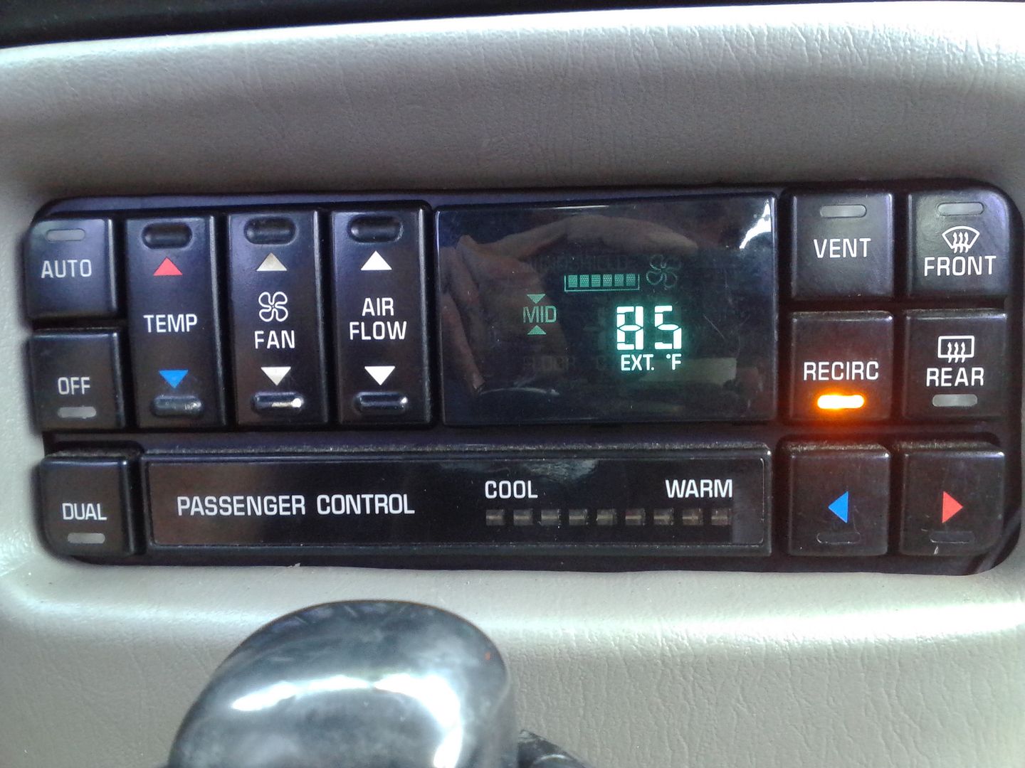

  7. #28787 Re: What did you do to your Car today?
    winner winner chicken dinner. its never been this bright since ive owned it.

    To me that looks so much better than the stock GP HVAC stuff. Good work man!
    Edit: I know you don't have a GP, I'm thinking about swapping those controls over to a GP.
  9. #28789 Re: What did you do to your Car today?
    knowing you and your lack of fear of wires, i bet you get it done lol
    thanks. a bit of heat and solder and its like new again.
    i do have one bulb out on the temp button you only see its out at night, seen that how too, so i checked the board out, looks easy enough too. if more burn out ill do em all.
