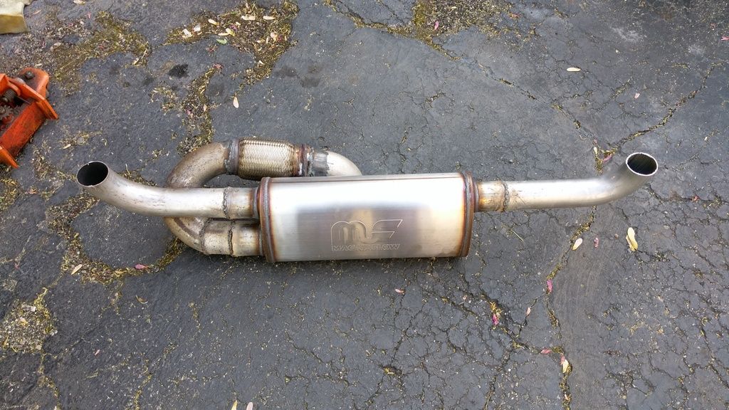

    Been driving it daily for about 3 weeks now to work and back. It's pretty fun to drive. Kinda loud but I just installed a Magnaflow muffler and it sounds a little better. Just waiting for the tips to come in.
