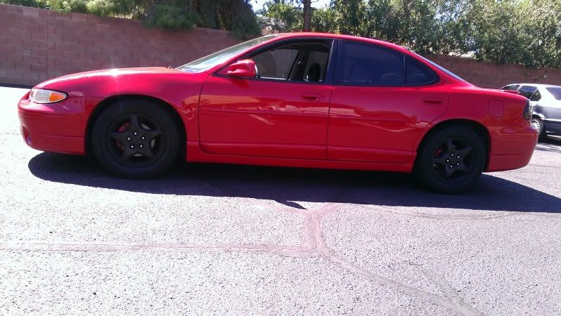

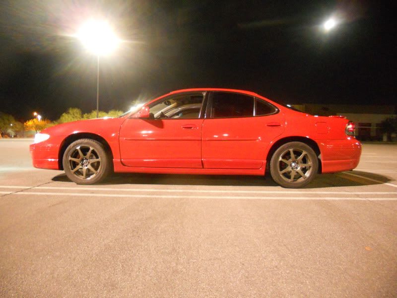

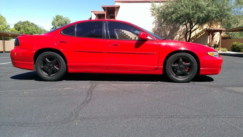

    I know I'm late but I have then with before pics and I'd be more that willing to send some after pics. I got the ssc lowering springs with the gr2s and I felt a huge difference. The cars isnt too stiff but its definitely more responsive. It's lower with no body roll. It's a great set up for the money I personally. It closes the wheel gap pretty well. It's not "hella flush" its hella functional! oh and no more wheel hop!

    all of these photo's were taken before the spring strut combo was installed.

    After, those are the factory rims with the same tires as the other pictures above but i plasti dipped them a few weeks ago to see if i would like black rims on there. The bronze rims/tire set up are the same size as well.
