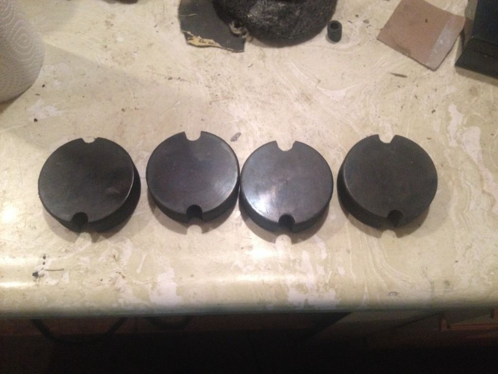

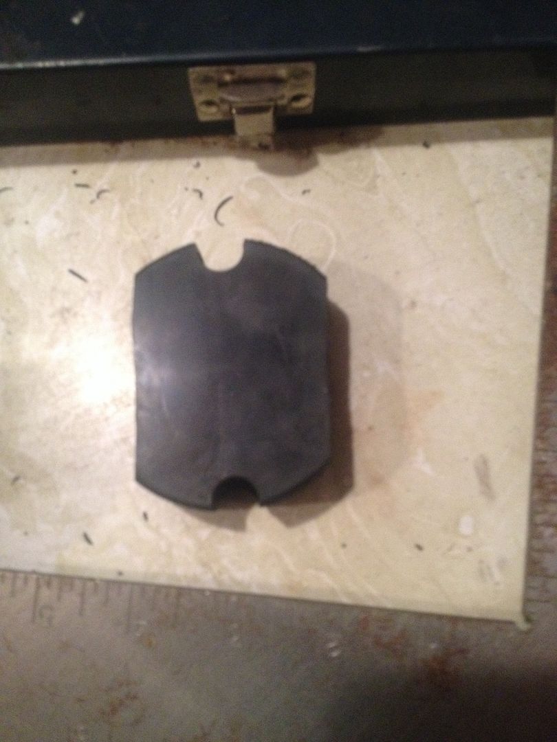

    Controlling roll for $4. Drilled and trimmed hockey pucks to fit between front right spring. Local car shop could order spacers in for $50CDN plus tax and shipping came to $80.

    The hockey pucks did make a difference in the front. I am going to try this in the RR spring and see if there is any improvement.
