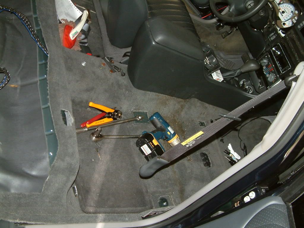

    This is the only place I could find that looks possible to run the cable through. I tried to remove the rubber grommet with my hands, but was unsuccessful. I did not use to much force, just incase I couldnt get it in.
    Is this where I need to run the cable?

  7. #7 Re: Where to run the power cable from battery to trunk
    Jul 2008
    nj
    130
    That is exactly where you need to run the cable. You just push it thought the grommet an find it on the inside of the car. If I remember correctly, you have to go under the dash along the floor in the center of the car. It is a little high. If it is too difficult, I always find that it is easier to push through a smaller wire first to pull the larger one with.

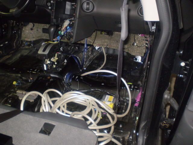

    Here is the picture of my 4ga Power wire I ran. I ran mine through the same spot where all my gauges run through. And then I just ran it along the door sil passanger side of the car. I just unscrewed and removed the plastic sils and fed the cable through there. I am going to be redoing my power line, going to 0/1ga wire, here in next the month. I then ran my RCAs up under the tranny hump to the rear.
    You can see the RCA cables in the center near the tranny hump. And a little tip, its a heck of a lot easier with the passanger seat removed

    No ripping apart your dash, just pull off the fabric trim under the glove box and the plastic trim along the floor at the door to pull back the carpet. Push the wire through atleast a foot to make sure that there is enough for you to find and then go hunting. You can not get any better pics than what is already posted
    edit, mine always end up under the black rubber that you see in the pics above. I guess my car is just a little odd

    It should be fine going through either grommet...and I would second doing it along the door bottoms under the sill plates...I ran numerous wires inside a 1" loom through there when I installed my CARPC.

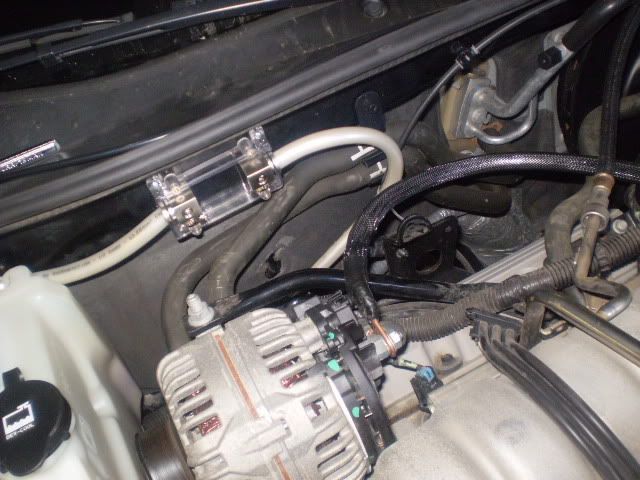

    I got it done. Came out to $100. Power and Remote wires all installed. Ran very clean through the side trim. This job was done in one day and the amp part was done in 20* weather so it looks rather ghetto at the moment but it bumps very hard!
    Here are some pics:
    Yes I know it does not look like the best install, but as long as it is safe, I do not think anyone is going to be a sub critic when they sit in the back seat and enjoy the back masage
    Oh and I also forgot to get pics of the switch that was installed under the dash and quality of the job done under the hood. I will get those soon
