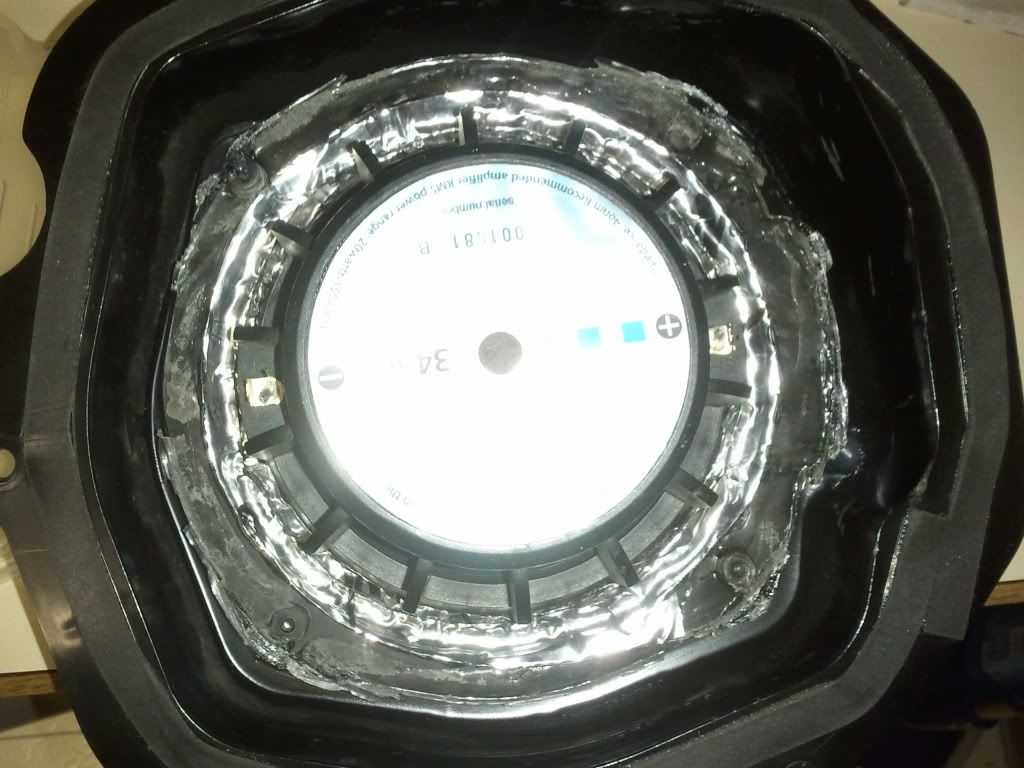

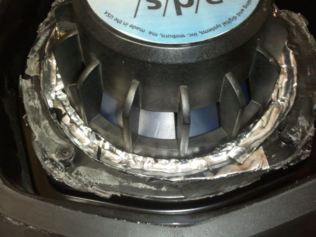

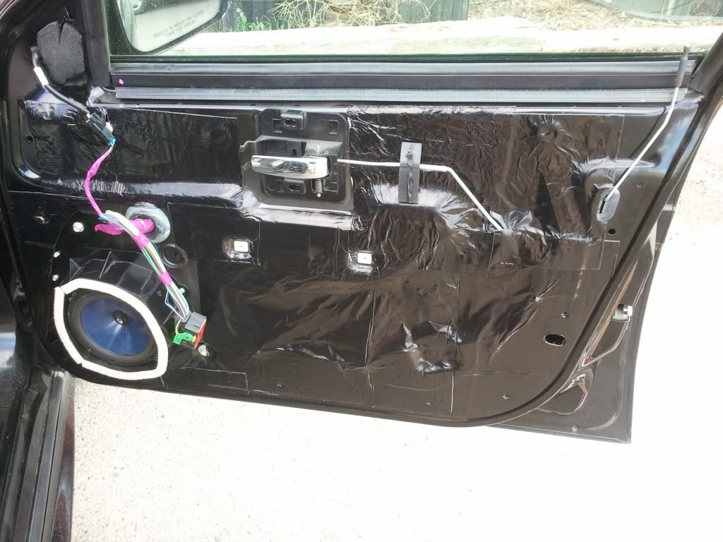

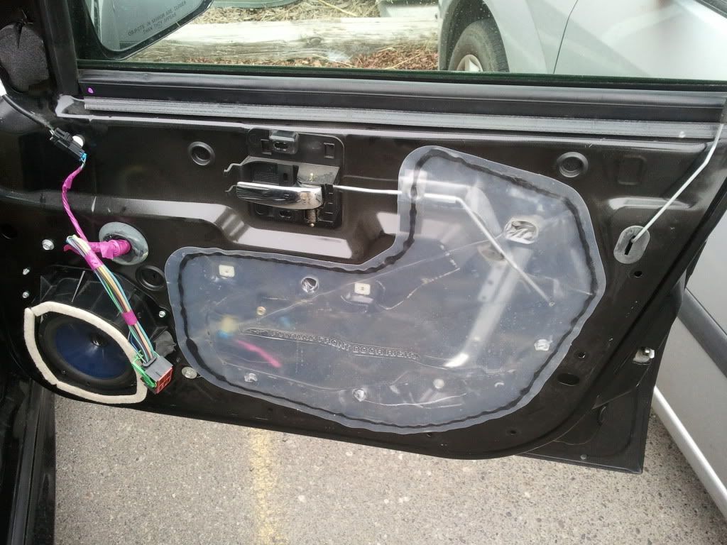

    I somewhat finished the doors too...still need Closed Cell Foam.
    <b>w/o Hushmat</b>
    <b>with Hushmat</B>

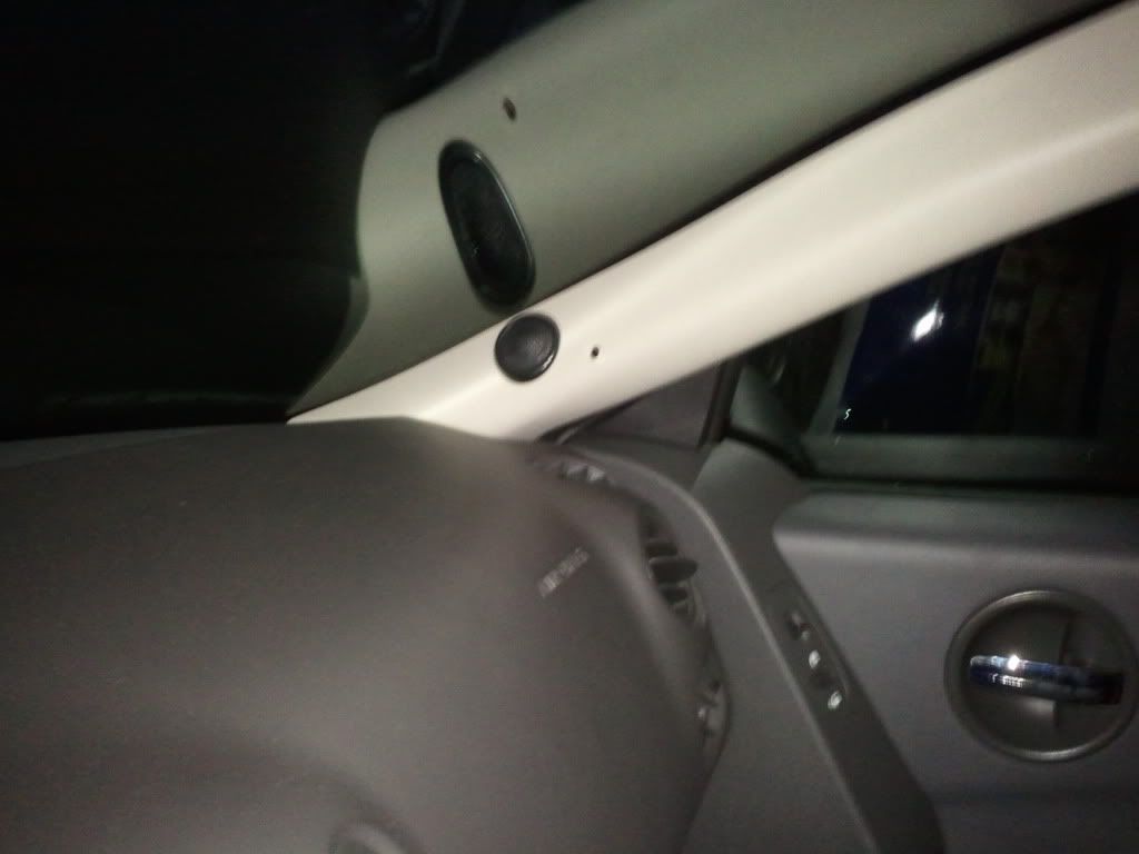

    I plan on wrapping my A pillars in vinyl right now but we'll see what happens. I'd like to do myself even...
    I also put some random Dynamat I had laying around around the underside of the speaker where it attaches to the baffle. Then I used extruded butyl on the baffle to make sure I had a tight seal.

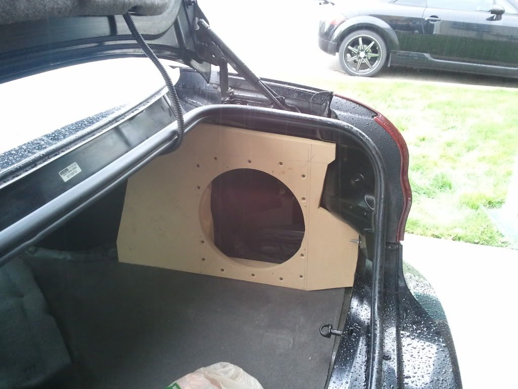

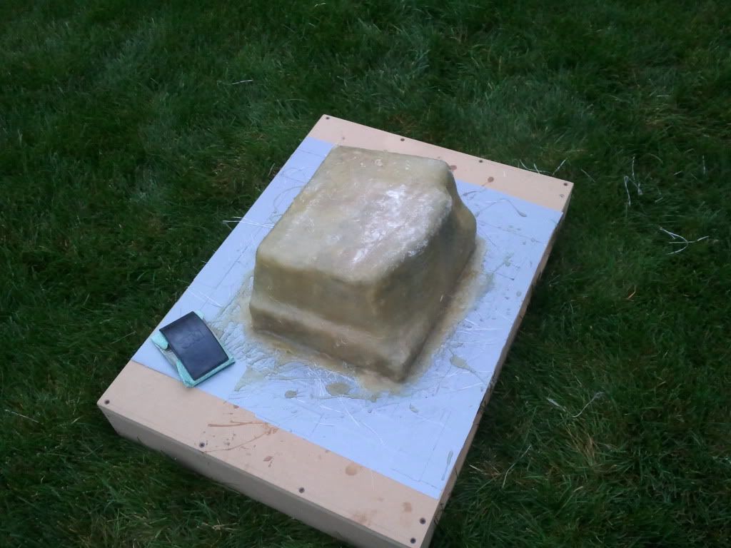

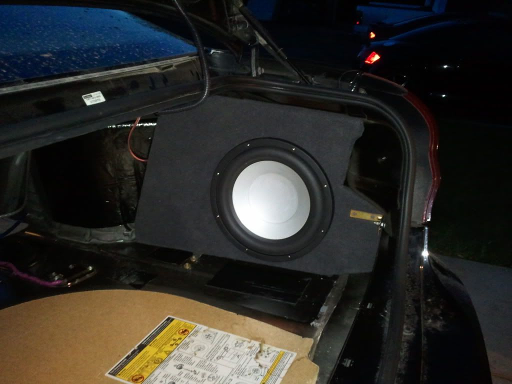

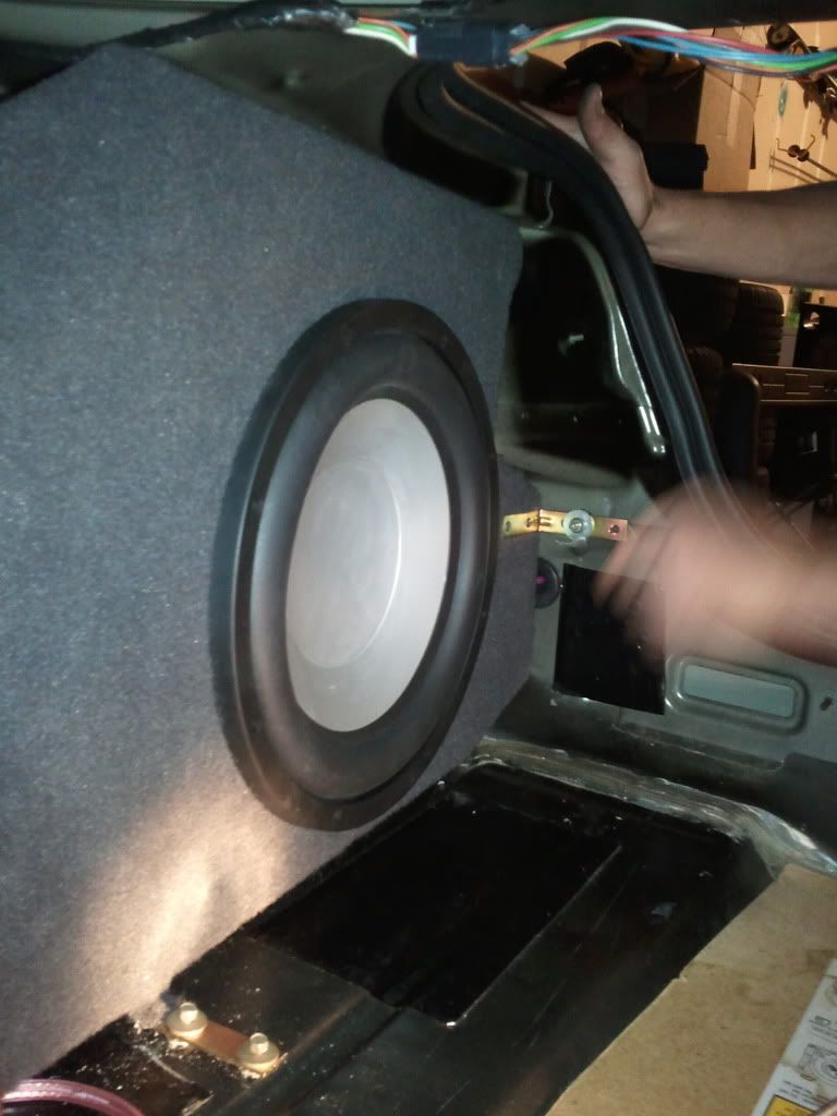

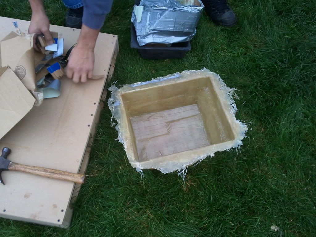

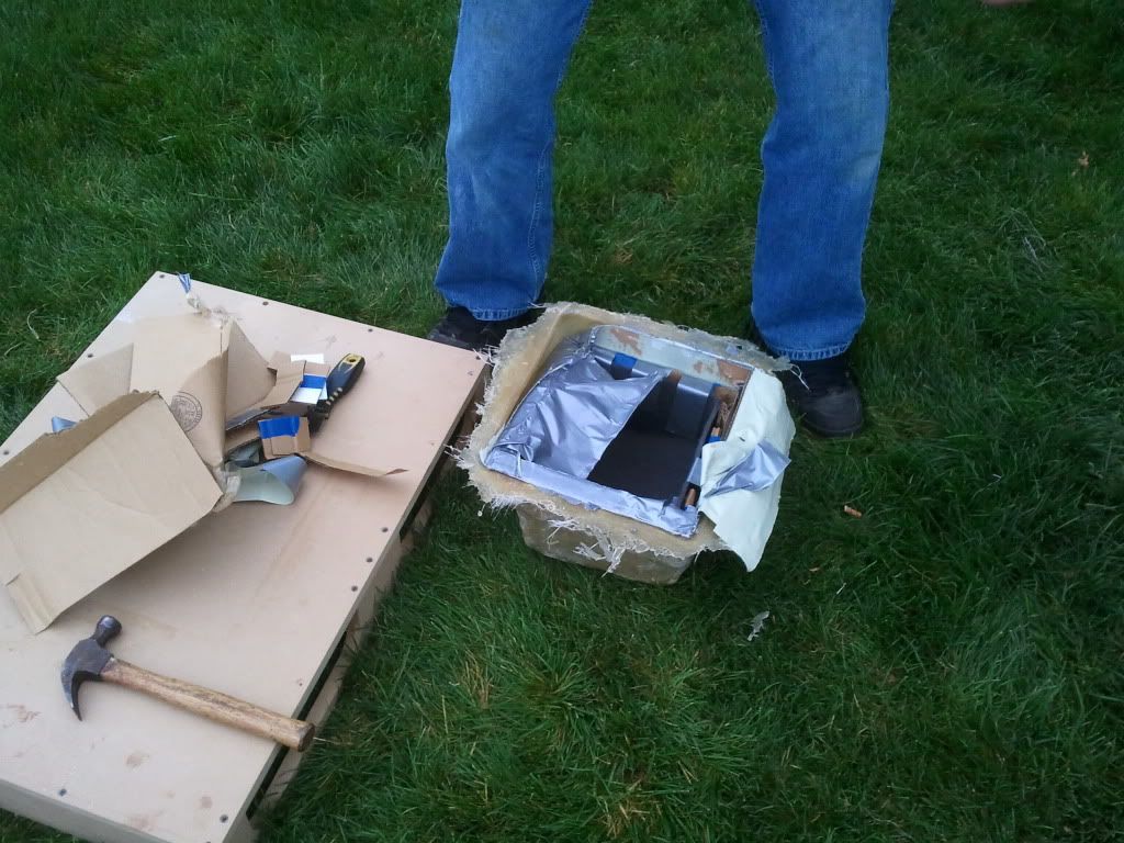

    I'm excited. I have a slew of posts and pictures. This weekend I'm going to start fiberglassing subs behind the tail lights. Hopefully that works out well

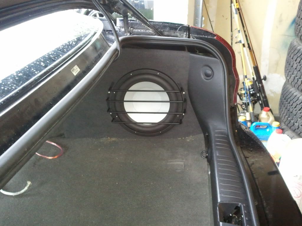

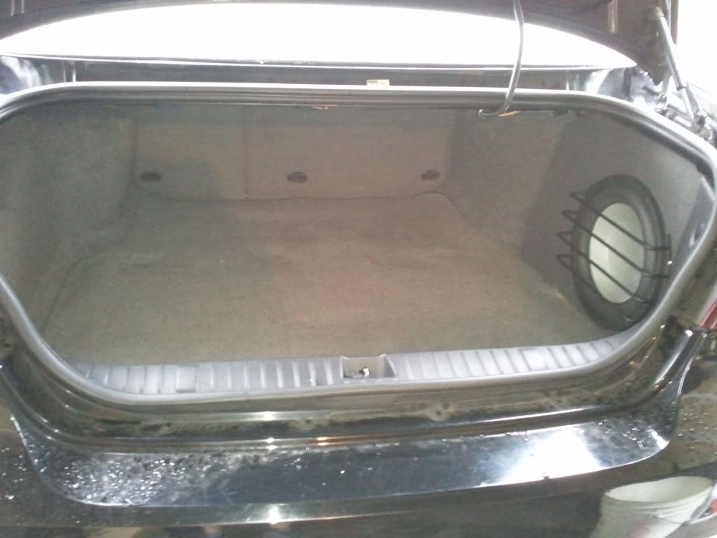

    Here's the build pics.

  8. #8 Re: Changing my Audio Install

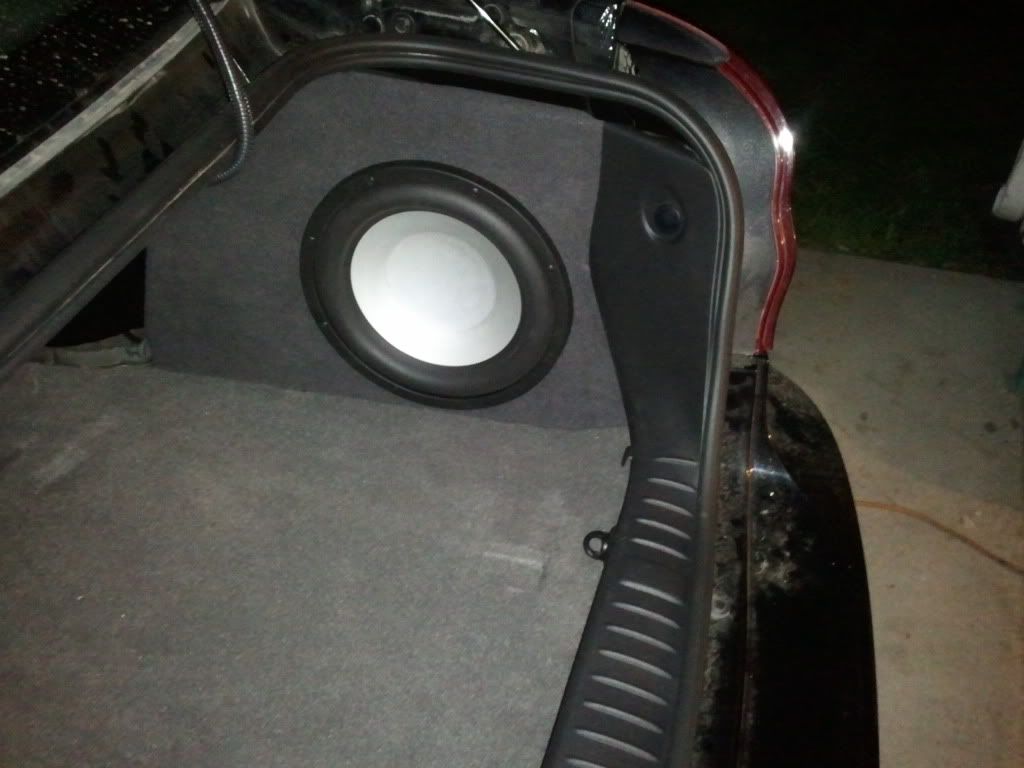

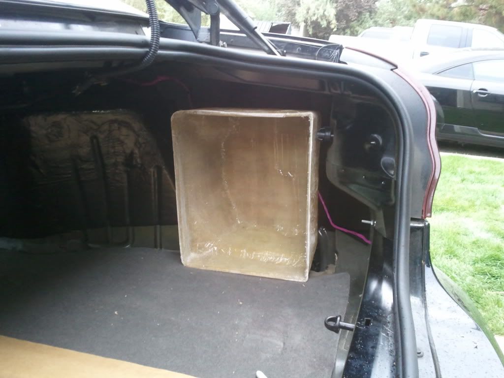

    I hate subs in trunk.
    Opening/closing the pass through has such a significant effect on how it sounds.
  9. #9 Re: Changing my Audio Install
    Feb 2009
    Virginia
    1,183
    Your sub is in your trunk!! I wanted to put it under the dash but I found out I really don't have the room with the current sub selection. Also, I really don't want to deal with ears popping when I roll down windows...so I left that pass through alone.
    11 is louder than 10!
  10. #10 Re: Changing my Audio Install
    Yeah, and I hate it.
    If i wasnt so lazy I'd build a bandpass. Eliminates trunk rattle before it even happens.
    Thats a DIYMA 12 right?
  11. #11 Re: Changing my Audio Install
    Feb 2009
    Virginia
    1,183
    It sure is! I updated photos. .5 cubic feet after deducting for speaker displacement. It'll be functioning off about 600watts bridged from the Leviathan. If I didn't want trunk space I'd build a bandpass too I wonder if I could model something for that fiberglass enclosure?

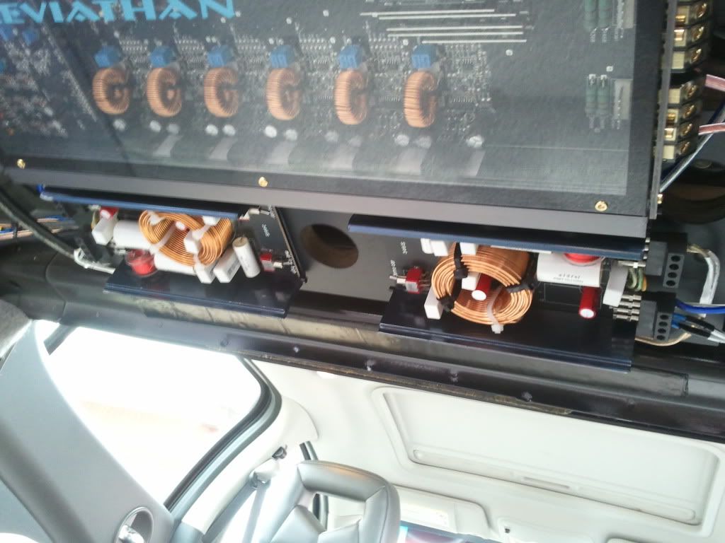

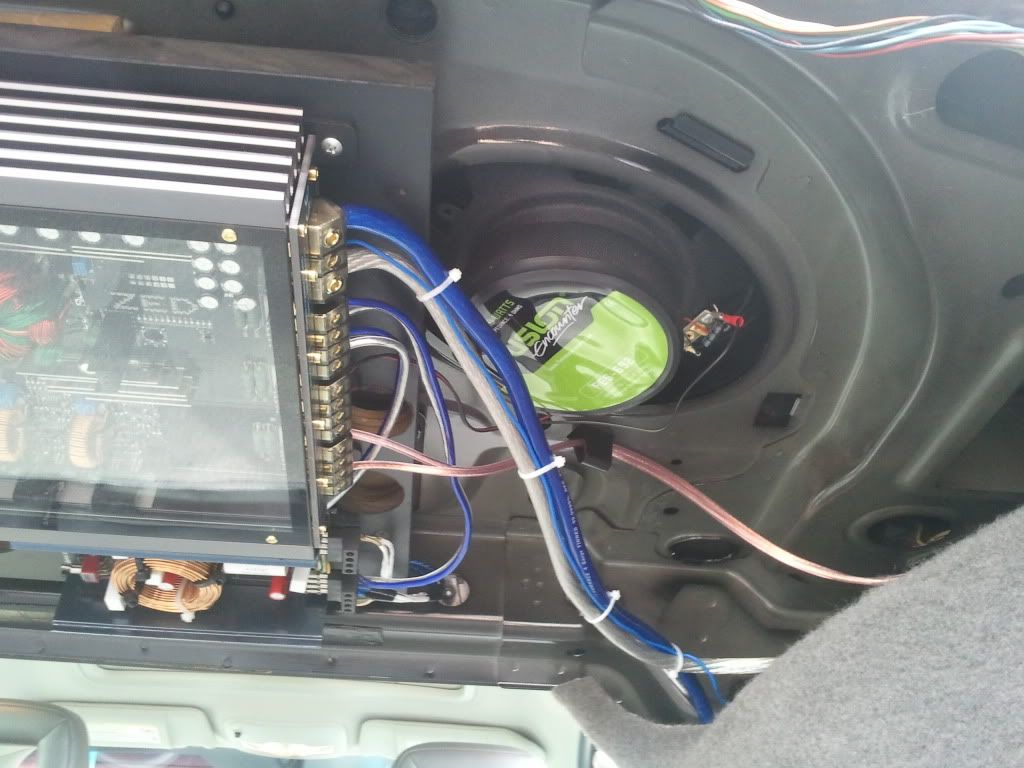

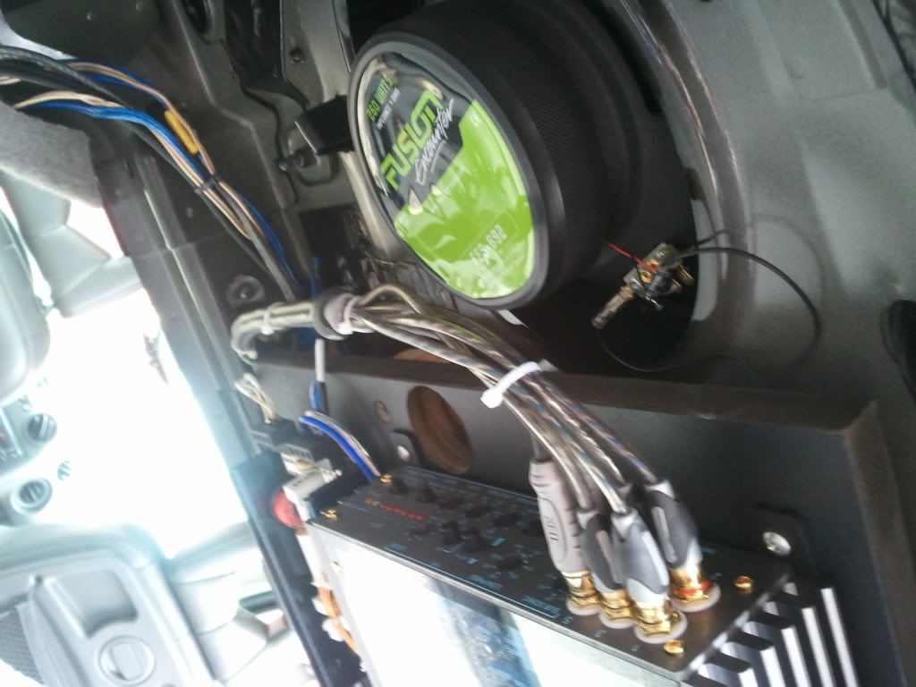

    Installed the Leviathan...
    Now I just need to add a "face" plate to it so all you see is my amp!

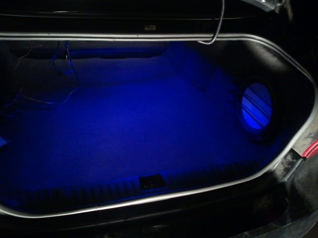

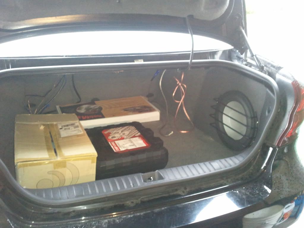

    Here's the amp glow in the trunk at night...not sure I like it yet...

    lulz.
    free neons?
    What are those crossover-esque devices?
  17. #17 Re: Changing my Audio Install
    Feb 2009
    Virginia
    1,183
    Ya...I'm not too fond of the free 'lighting'
    http://www.diymobileaudio.com/forum/...not-346cs.html
    That's a link to the cross overs...mine were damaged so I took them apart. I want to get some plexi and maybe make them displayable in a cut out in the face plate.

    What happened to active?
    All you need is a cap on your tweets (or better yet a fuse and a cap...)

    I decided to check out my passive x-overs and for whatever reason they ended up sounding really good with this setup. Originally it was trash with several other setups I tried. I think they designed the cross overs for an A-pillar install because the mid has a 6db LP slope. For whatever reason it works pretty well. *shrugs*
