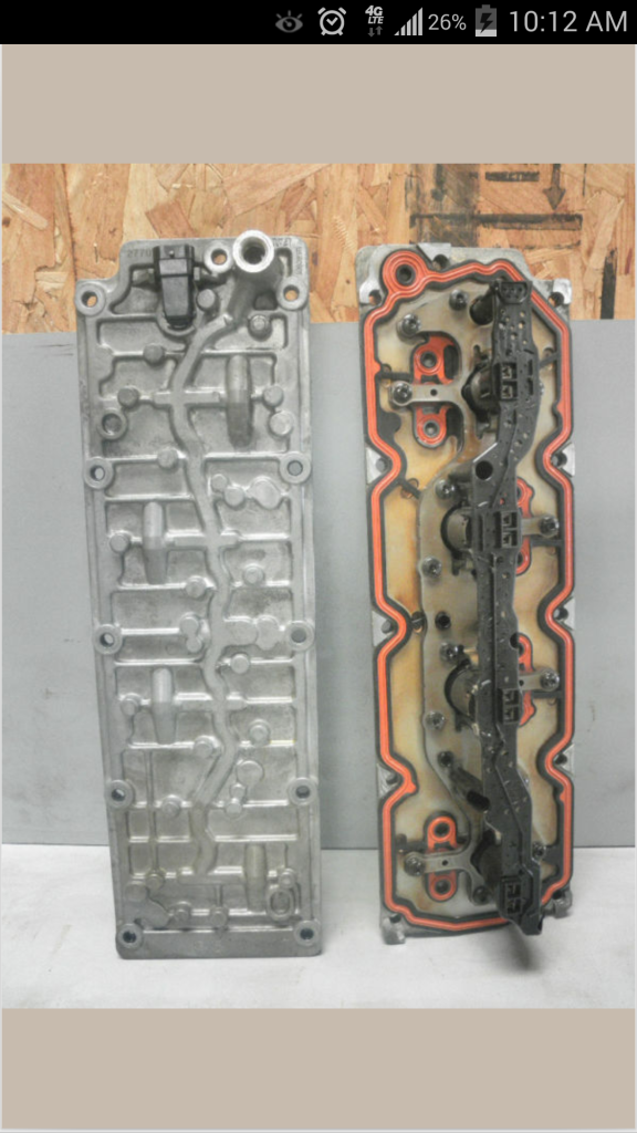

    This is the one I was looking at. Is this the right one? It's listed as LS3 L76 L92 GM 5.3 5.7 6.0 6.2 intake Valley cover w/DoD

  12. #12 Re: Ls1 intake swap
    Arizona
    2,930
    Yes sir.

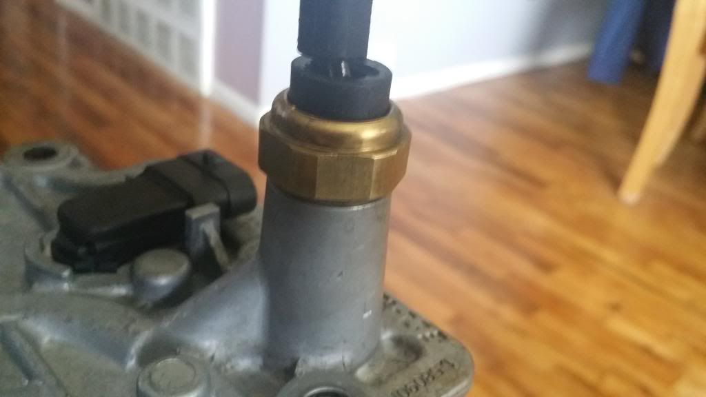

    Just got my valley tray in the mail. This connector was broken upon delivery. Will this be a issue? Thanks

  15. #15 Re: Ls1 intake swap
    Arizona
    2,930
    Nope just reuse tyour cuurnt one

    Question, why couldn't he use that tray in his first post?
    Email all inquiries to willoverkill@gmail.com!
  17. #17 Re: Ls1 intake swap
    Arizona
    2,930
    Quote Originally Posted by Overkill View Post
    cause he still has stock dod lifters...if he were to go full out non dod cam lifters etc then he could use that cover.
    Even with the dod being turned off in the tune you still can't use that cover till you delete dod mechanically
