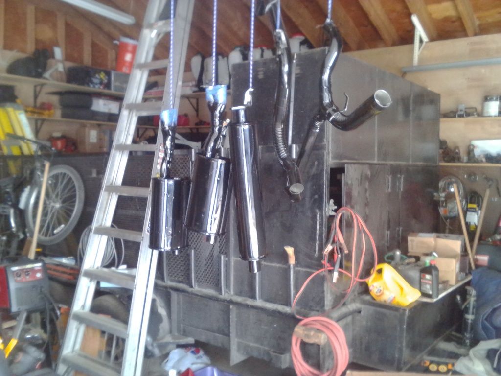

    i just installed a ebay cat back, swapped to dual mufflers, came shipped for like 300. its quiet like stock the way i like it, no rasp or drone and raspberry fart sounds from it either.
    i painted it all with high heat paint too to give it a fighting chance at life here.

  10. #10 Re: Does the GXP have stock resonators?
    the only down side is the paint stinks like crap every time it gets hot for a while. it just stopped smelling a few weeks back now.

    all that paint burned off scotty
    no its all still there. but it takes many heat cycles till you stop smelling it. it did smoke like a muther the first drive. i also let it sit for like 3 days after being painted. so one its heat cured it stops smelling.
    once i smelt the paint burning off i knew instantly what that smell was that was coming from my engine when it got swapped lol
