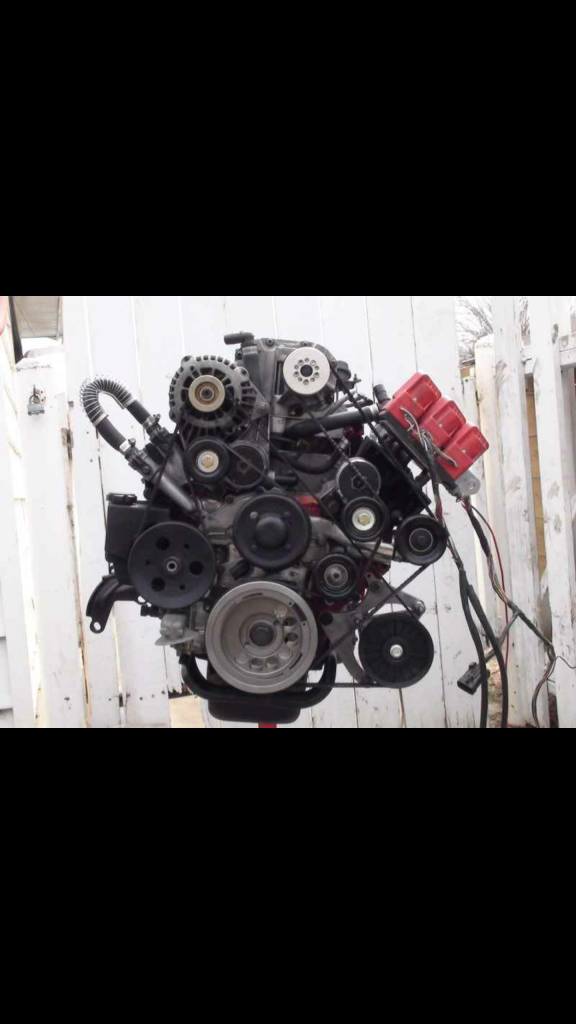

    So everyone. I have 2 noises coming from the motor. One of them is old and it's a lower pitch ticking noise. I think it's the compressor. But I'm probably wrong. The second is new. It's a high pitch kind of squeal I guess. Anyone hear this before?
    2 3800 engine noises. 1 new 1 old: http://youtu.be/WJXOYZ1nefo

    thats a bad idler or tensioner pulley. take the belts off and hand spin all the pulleys.

    all of it. take the belts off fire it up, if you hear nothing now the pulleys are bad.

    Oh boy. You were right about that.
    But guess what happened today...
    The front compressor bracket snapped in half and the compressor fell off. And snapped my belts. So now I get to go to the junkyard tomorrow when it's 30 below outside. Yay.!

    now that really blows. a/c clutch seized up on ya. take the compressor as well. the bracket didnt snap for no reason, thats for sure.
