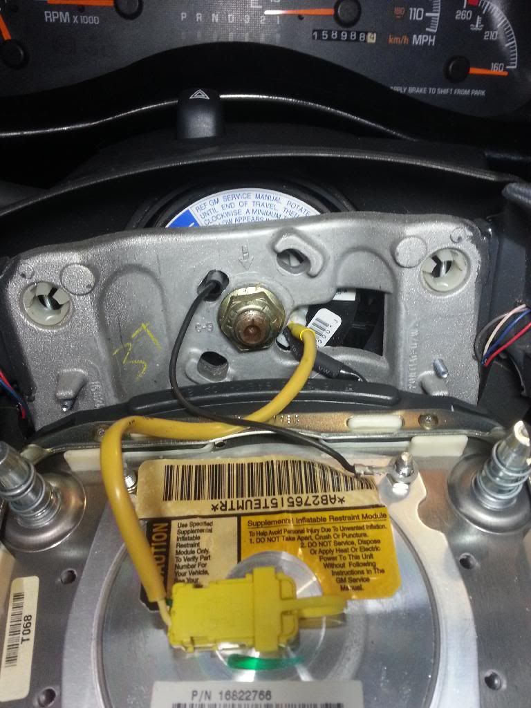

    so ive seen every thread on here. I hotwired the horn and it worked. I replaced the blown fuse. I checked the ground under the airbag and it looks fine. idk what to do.. please help. is there supposed to be a nut on this?

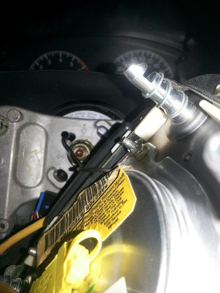

    just came across something strange. when I was wiggling out the 4 prong fuse under the hood the horn went off. it happened when I tilted it upwards...

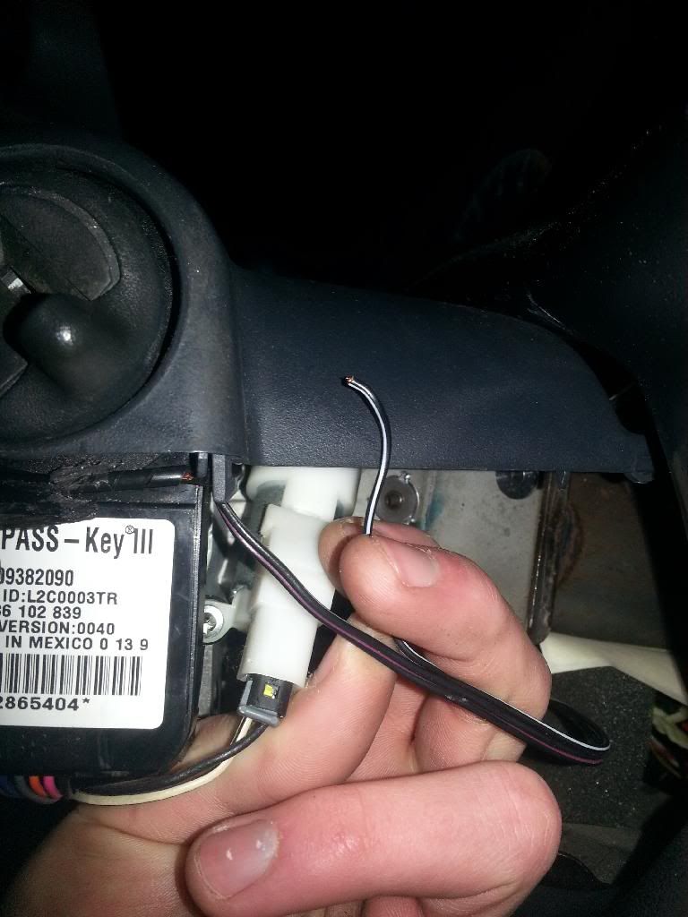

    I also found this. is it important?

    Well now you know the issue if from the b+ wire that activates the horn relay, from the steering wheel to the power distribution box. Did you ever see if that wire that's broken is the wire you're looking for? Check to make sure there's no voltage there then check resistance. Should get the resistance of a relay, if so solder it to where it should be. If not find the horn wire and make sure it's intact.

    there are only 2 wires. one is black and one is yellow. haha black and yellow...

    does your air bag have 2 wires coming out of it? one is the push in and turn to lock it in the whole. the other the black one has a clip in the end, it fits on the treads sticking out of the steering wheel.

    Just found out that the wire in that picture is for my remote start. dam. How do I find the horn wire

    the yellow wire in the middle is the air bag to clock spring, the other black wire next to the yellow wire is the radio controls.
    that black wire looks wrong to me. (clipped to the air bag) you need two wires out of the air bag. the push in and turn one there thats power, not the ground.
    at least on my car.
    i bet if you take that wire off the air bag, the black one, and then ground it. the horn beeps. thats after you change the fuse again, cause that would explain the blown fuse.

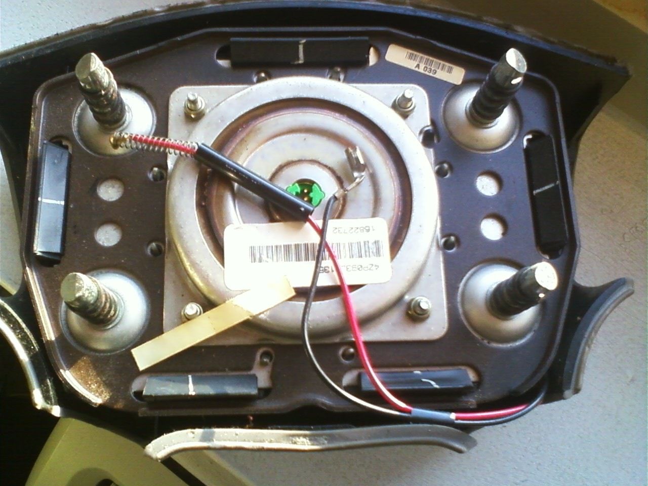

    found this pic of one for sale seems to only have the one wire too. very odd.

    some how i bet the horn button is bad or a bad contact in the air bag cover, it should come off with them clips on the 4 sides.
