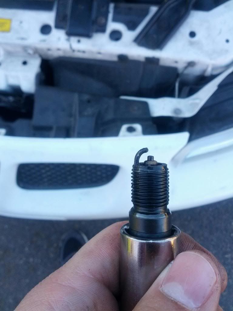

    So I removed the oil cap and theres air coming out like a freight train! lol decided to check my plugs and the front left plug is messed up. the tip is completely gone, down about 1/4 inch in the plug. the middle front L shaped tip looks like its getting burned since some of it is missing. the front right is ok. Haven't checked the rears yet. What can cause this to happen to the spark plugs?? they only have 25K miles on them or so. Im going to replace the PCV valve and spark plugs (they were Autolite 104s). What should they be gapped at? since I'm running a GEN3 with XP cam and 3.2" pulley...and all the other supporting mods.

  10. #10 Re: Major Problems-Blown gaskets
    GT Level Member Steven Monteith's Avatar
    May 2012
    Phoenix, AZ
    281
    Here's the middle front. First pic is front left
  11. #11 Re: Major Problems-Blown gaskets
    May 2012
    Phoenix, AZ
    281
  12. #12 Re: Major Problems-Blown gaskets
    GT Level Member WolvesSoulZ's Avatar
    Québec
    386
    That plug looks like it got smashed by a part of the piston.
    2000 GT - L67 swapped SOLD | 2004 GT1 - Winter Beater - SOLD
    2004 GTP Comp-G - 3.3"/3.2", XP, #50 , 4" MAF, SD's, 180*, AL103's, HAI, Tuned, 06+ Dual pistons brakes, STB's, SSC's and FE3.
    2011 Audi A6 S-Line - Also Supercharged
  13. #13 Re: Major Problems-Blown gaskets
    Aug 2011
    'Merica
    7,358
    Chipped piston.......
