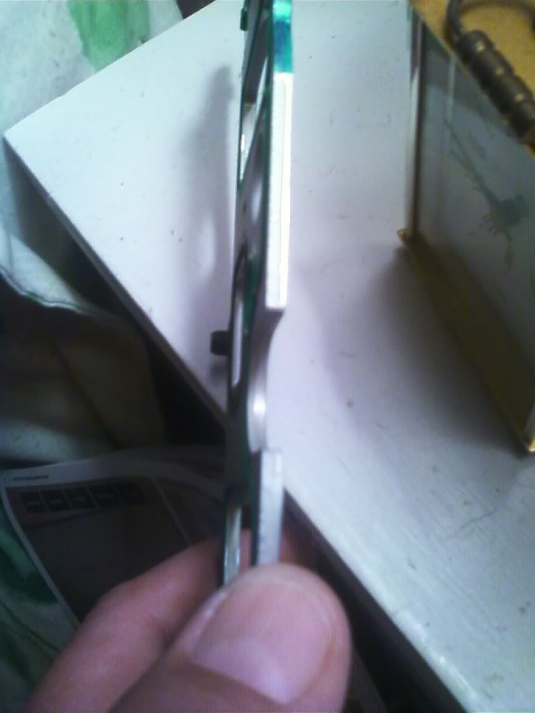

you did order the metal gaskets right? for the intake.
if you look where the lim meets the head, you can see the old gasket in there, they are quite thick, if you see black, its the old gaskets, silver, you have the new metal gaskets.
metal lim gaskets.

wrong set.
i got a ac delco set from rock auto 43 shipped. came in like 4 days. also found a discount code for rock auto, got like 3 bucks off, so it came to free shipping in the end.
the metal ones will say metal, and shine like metal. rock auto has pics too.

These then? Fel-Pro MS98014T - Intake Manifold Gasket Set | O'Reilly Auto Parts
They look to be metal. I can probably get Oreilly's to price match Rock Auto's price of $48.99.
thats a nice set, they have all the injector O rings and stuff, yes those will do the trick.
