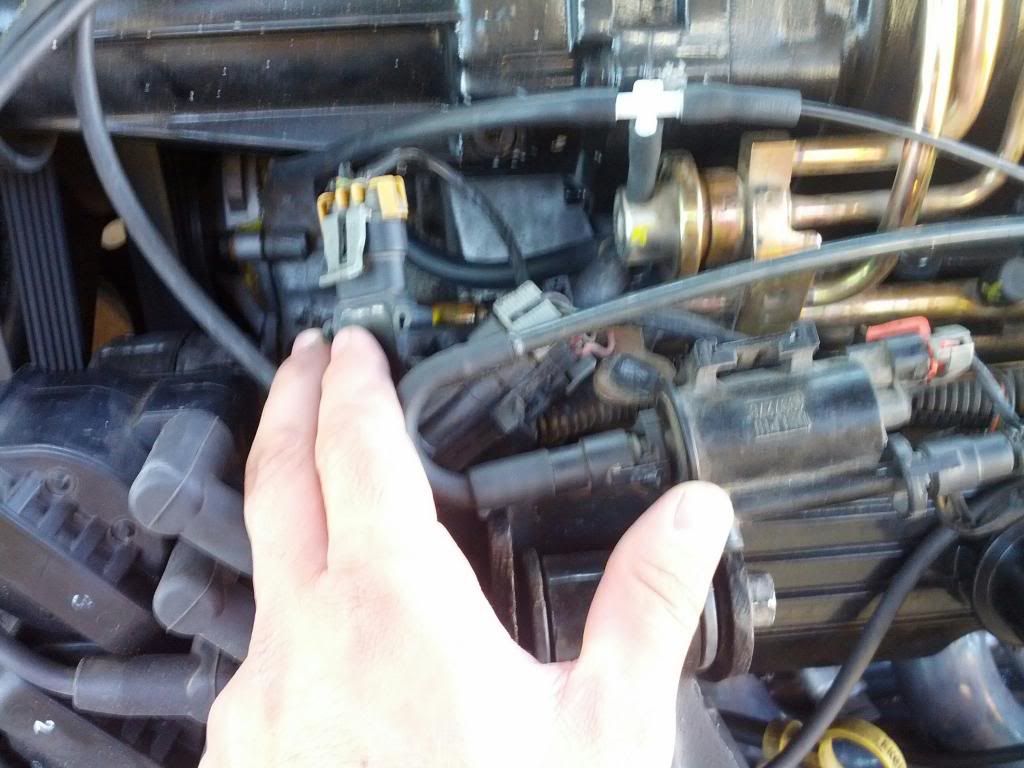

Am I looking for the evap canister purge SOL?? is that the one your talking about?
Heres my map sensor and Evap Canister. both in the front
http://i1322.photobucket.com/albums/...126_144426.jpg
