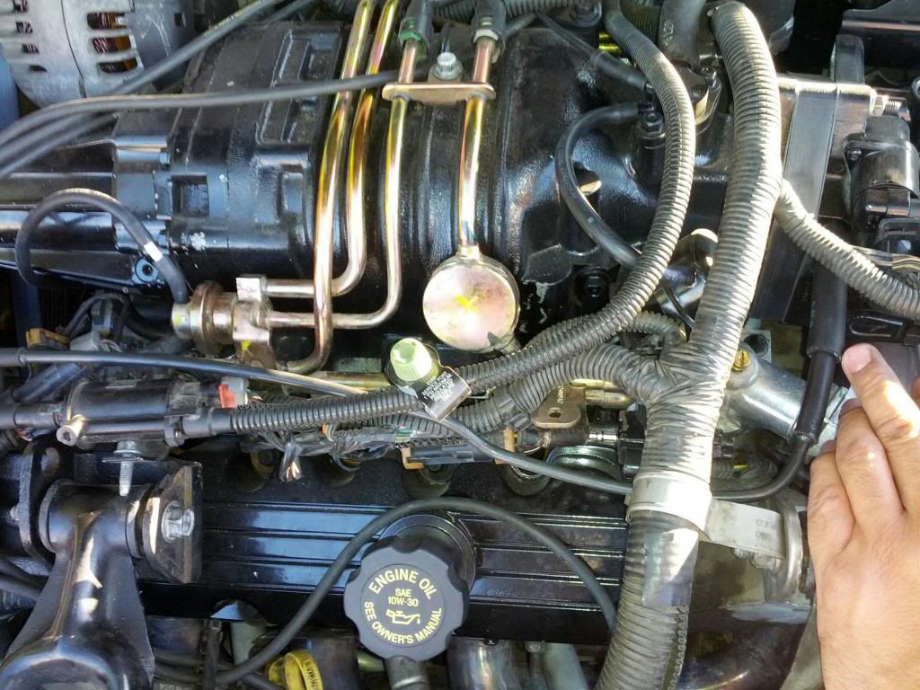

So instead of the 2 lines coming from the throttle body, just use a fat one to go from the throttle body to the thick line in the pic going to the evap canister??
tb to evap SOL. evap to the canister.
Heres what I just did. I did one big hose from the throttle body to the evap canister. regulator and map sensor are going to the LIM. BBV is connected on top. Bottom of BBV is open. Still getting 2.9lbs of boost. Any other suggestions?
http://i1322.photobucket.com/albums/...126_161803.jpg
wheres the vac line to the by pass solenoid? like in post 48 of this thread? fuel pressure reg gets a T then to the by pass solenoid.
i know you have things all this and that way, so it makes it hard to tell just what is going on completely.
I don't have anything going to the bypass solenoid. Some one on here posted a video showing his vac lines and he didn't have anything going to the bypass solenoid. He said its not needed
well maybe that guys wrong. put a T on the fuel pressure reg, and then off to the by pass. see what happens. at least thats closer to the way it should be.
Maybe, but he's putting out good boost. I'll give it a try. Theres 2 connections on the other side of the bypass solenoid, what do I do with those? the diagram shows to run a line from one of them to the bottom of the BBV. Is that correct?
one of the nipples is supposed to be free of anything, its supposed to have a sponge like filter on it.
i think its got 2 clips on the sides of the vac nipple, iirc the open one is the top one, the lower one gets hooked up to the by pass actuator. if im remembering right.
its a long walk to my car to check or i would.
I hooked everything up exactly to what the diagram is. tried both nipples on the bypass solenoid and still only 2.9lbs.
