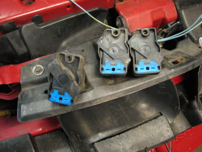

    no, i should get the icm this week. i just place dibs on this, ClubGP Message Forum troubleshooting the coils on my car are from a n/a gt. i beleive it should come with the icm as pictured
    Other Peoples Reject....The Red Ripper!
  11. #31 Re: Red Ripper Engine Code
    Len...
    If you put MSD coils on, you are basically guaranteed to have high rpm misfires very soon after. Sorry on that stuff, I'll get it in the mail tonight for you. I think I have a spare of each.
    The coils in question have blue under them.
    I thought blue was NA and yellow (slightly hotter spark) were SC. Swiggs, do you remember your colors?

    Len...
    well am not going to get the msd's if they have issues as such.

    so, the ones on my car are from a N/A
  15. #35 Re: Red Ripper Engine Code
    Donating Users
    MA
    257
    not necessarily.... mine are blue on the gtp so either you and I have N/A's or they are correct and OK.
