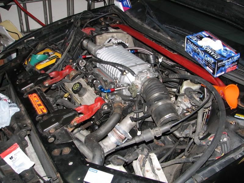

    M112 not common? If you want any pics of how the one I assembled for a guy was done, just holler.

    Looks like that's the expensive custom m112 case that I think Intense only made like 10 of. And yeah, post away. Do you remember what mods where on the car to handle the m112. Heads ported? I spoke with Trannyman and some local friends for advice on porting mine. My machinist was quite impressed how good they turned out. Either he didn't have high expectations for me or else I did a good job, lol.
