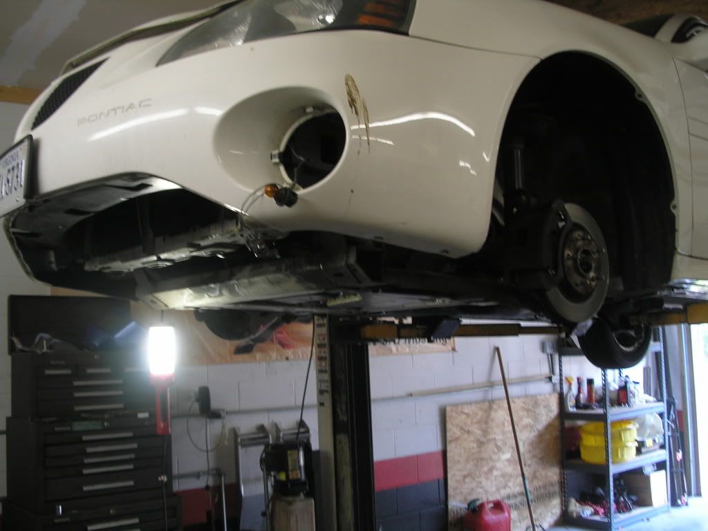

Ok so my buddy ditched me (actually family emergency) and I ended up having to swap the engine/trans/cradle and everything by myself. Did allot of reading (on here) before I started. It really wasn't as bad as I thought.

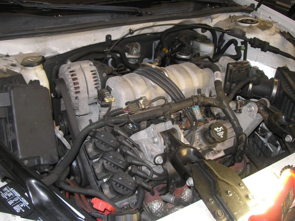

Started with my 04 n/a Grand Prix. I Unbolted the A/C compressor and brake calipers and hung them from the body so I didn't unhook them. (no bleeding or recharging) just bolted them back up to the new rotors and engine. Also, just unhooked the steering linkage since the GTP one was still intact along with the struts and all.

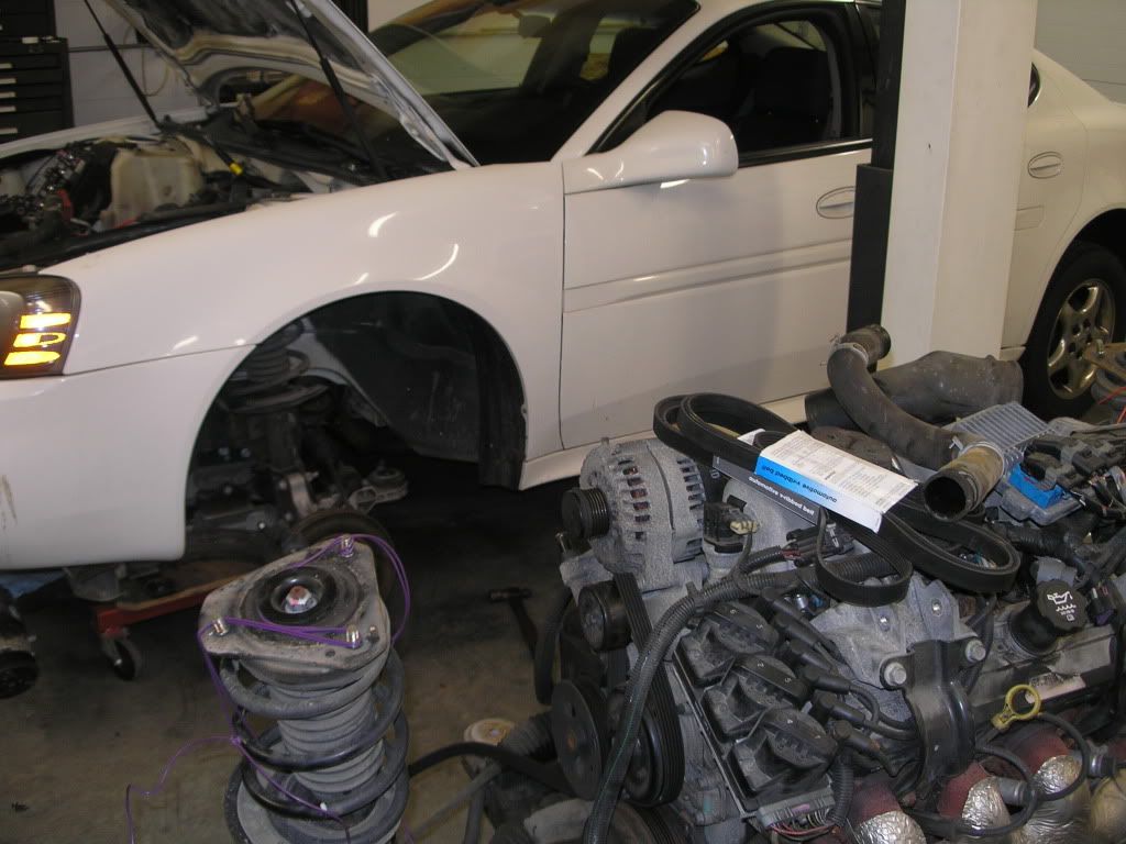

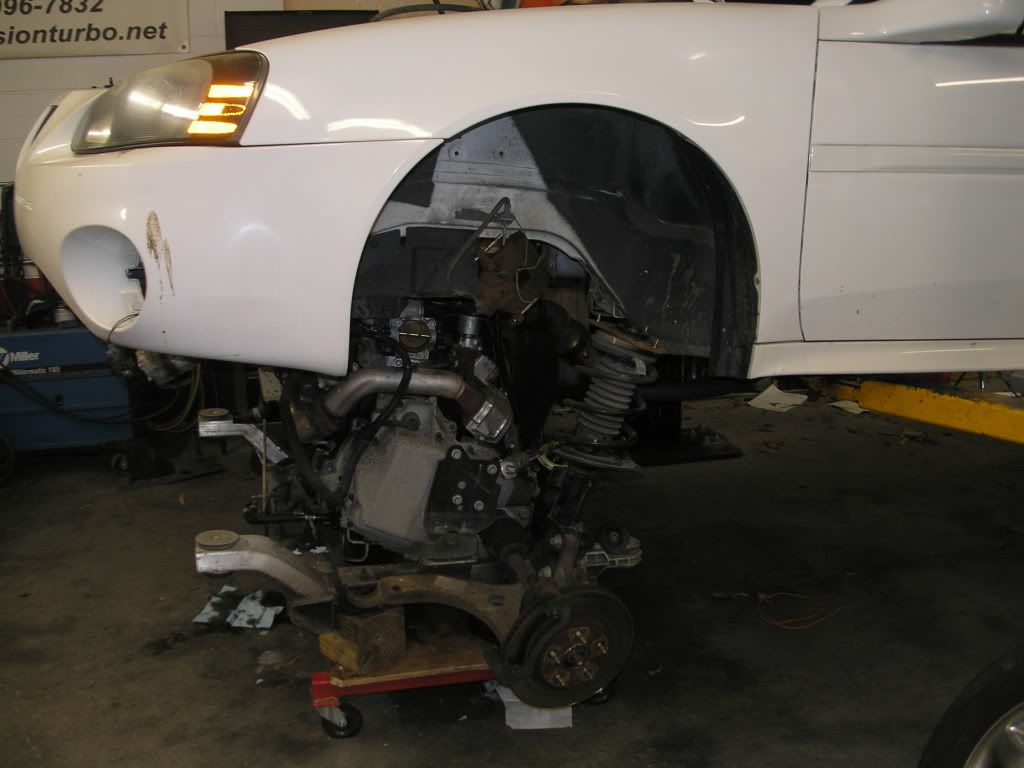

Then started the removal: it's nice to have a friend with a garage and a lift. Otherwise I don't think I could have done it alone. And in the process make my friend that couldn't help me feel bad that he couldn't. hahaha
And:
And:

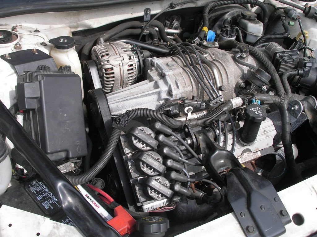

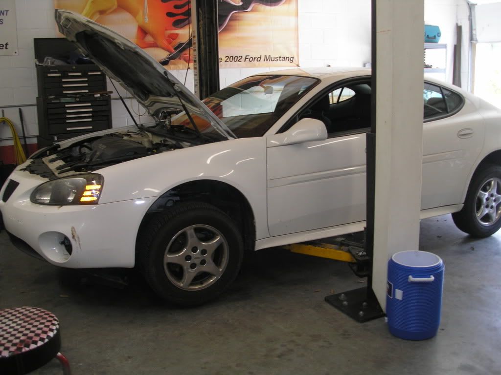

To this.
Now, things I found out that I had not read before I started: Even with the 05 PCM to install into the airbox. The BCM does NOT recognize the new PCM Vin #. So the car would not start. After allot of searching. I ended up Downloading the 05 GTP PCM files, then replaced the 04 n/a PCM and Flashed the 05 GTP files into the 04 PCM.
Now the car starts and runs AWESOME. For a stock 05 engine, I couldn't believe the huge difference from the n/a engine. IMO anyway.
