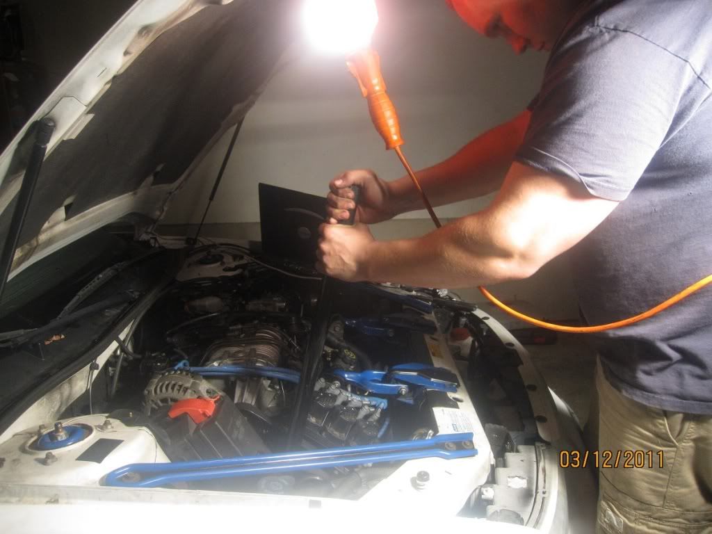

    Cam install, cradle is lowered. Impact gun with tank good to 150psi. Breaker bar. All has failed.
    I can try the breaker bar and jack it up with my floor jack trying to rotate the bolt but I am worried about what may happen if I am forced to wedge the crank from spinning.
    I am spinning counter clockwise.
    Next step may be put 1.9's back on and sell what I've got., because I'l sell before I pay a shop 800$ to go 3 more steps than I have.
    Tricks, Advice, Critisism all welcome.
    -Brooks

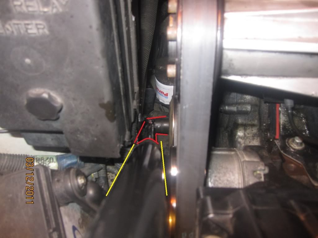

    I couldn't break mine free with an impact that is supposed to be rated for 600 ft/lbs in reverse. I ended up twisting a long extension in half trying to get it through the wheel well. The way I finally got it was with the socket right on the breaker bar and putting it straight down the front side of the engine. With a pipe on that, I was able to break it free.

    Its a 26 gallon tank, 5.5peak hp 1.7 maint with 150psi max. The hose is 9mm 3/8'' hooked up to a husky 275maxpsi impac gun. I hammered it for a good while with no success.
    I believe I actually tried that breaker method, I just cowered out after hearing some undesireable noises. I felt like I was going to break something if I racked it foreward much harder. Perhaps I should have just used my man hands and gone through with it. It's all back together now so I will have to try it for another day.

    Its all back together now, I was just showing silver gtp what I tried because I'm pretty sure its the same he was describing.

    Quote Originally Posted by Brooks View Post
    Yep, that's exactly how I did mine. Had to push pretty hard on that pipe to get it to break loose. If you block the flywheel from turning and use the same method, it should come off. Make sure you are pushing on the pipe and not pulling. We all have brain farts once in a while. It will be kinda rough at first. The whole back side of the head is coated with a red thread locker to stop the bolt from coming loose. It makes a little noise as you break that stuff free.
