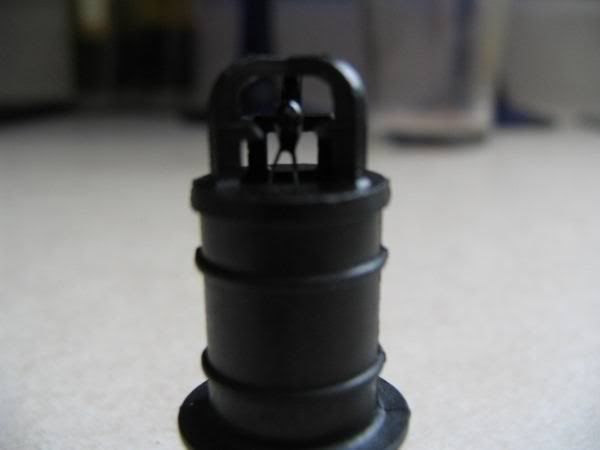

    Can you post a picture, so those of us curious enough can see how close to stock it looks?

    From the outside, you will not be able to tell that there is an aftermarket part installed. It uses the stock housing. The only noticable difference is the smaller element compared to stock. This is the only picture I have ATM of the new element. I can take side by side pictures this weekend of stock vs. modified.

    No need for another picture unless soemone else wants to see it. Thanks for posting, it's a good shot.
    Do you know how durable this thermistor is?

    As far as I know, it's just as durable as the stock on. Epoxy coated and all.
    I was concerned at first about this just from the small size of it, but a friend of mine has one that's the same style on his GTO that's been on there for going on 3 years now without any issues.
