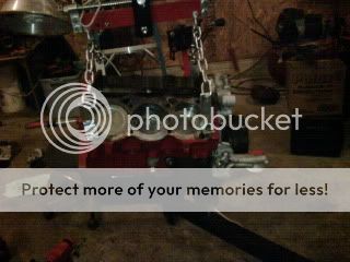

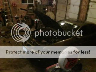

    Dropping in the short block tomorrow. Should be able to start it up tomorrow night.

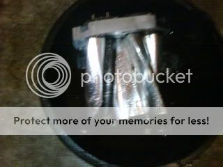

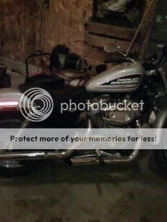

    crappy cell phone pics FTW!
    What your rotor pack should not look like
    and the non running bike
    SMGPFC Two Nipple General
  20. #20 Re: New build.
    Polished rotor pack for that high performance-ness
