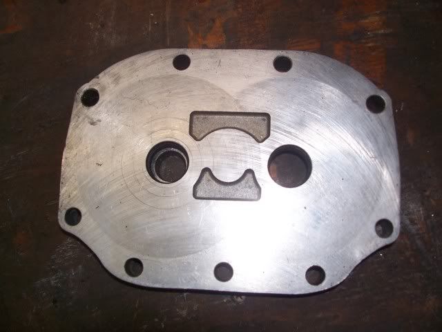

    Can you post a pix of what you are talking about on your custom billet rotor block?

    Quote Originally Posted by shawngtp View Post
    http://www.grandprixforums.net/my-bi...ock-36937.html
    The recesses in front of the rotors in the block have been eliminated ,No one Ive talk to seems to know what they are for but it seems strange that eaton have gone to the trouble of putting them in and no other blowers with similar shaped rotors have them either
