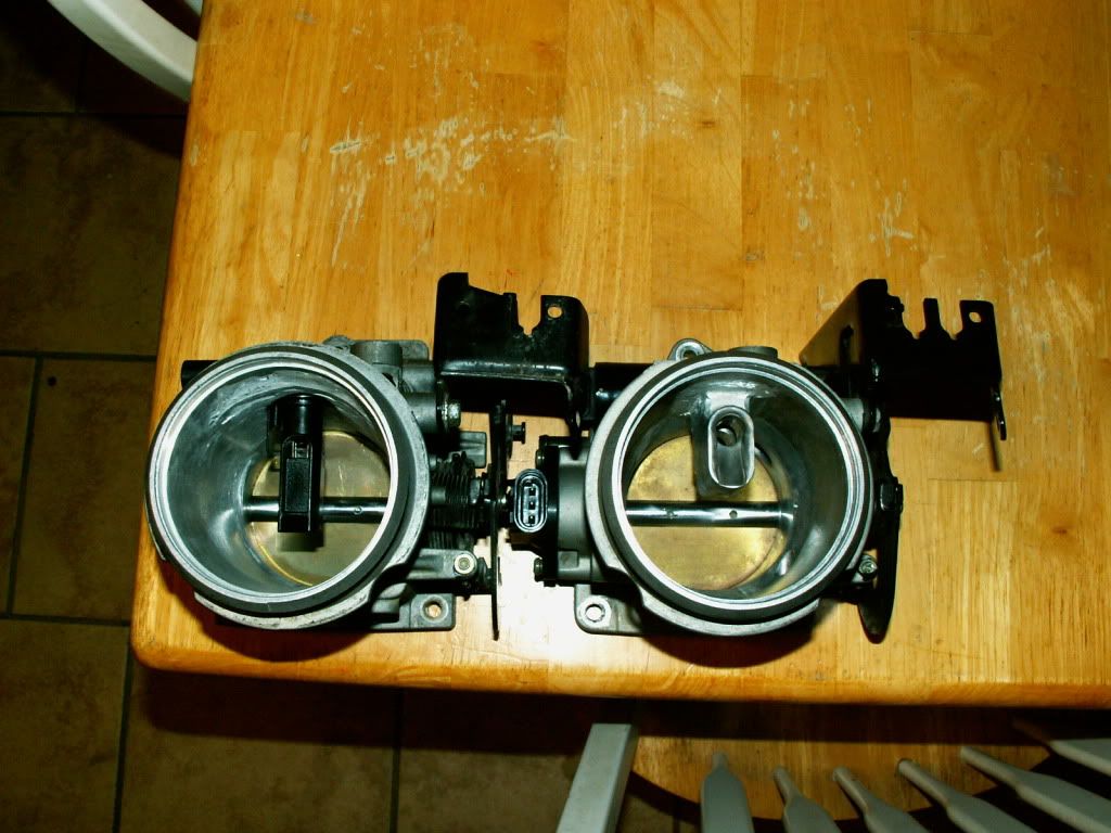

Which ported throttle body would you prefer to have? (Look at the pics before you vote)
BTW, neither of these is for my car, just some I did.

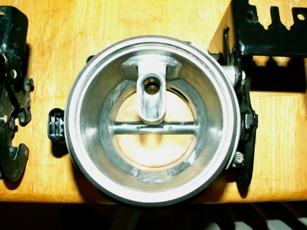

I have a '97-'98 TB that I removed a fair amount of the MAF bridge from, as well as ported.
I also have a '99+ TB that I ported and epoxied. Don't mind the non-perfect porting, it was a quickie.
From measurements taken, the '97-'98 TB has less intrusion from the MAF housing than the MAF of the '99+ TB. So, the older TB, when ported as I have done, seems like it would flow a little more air.
