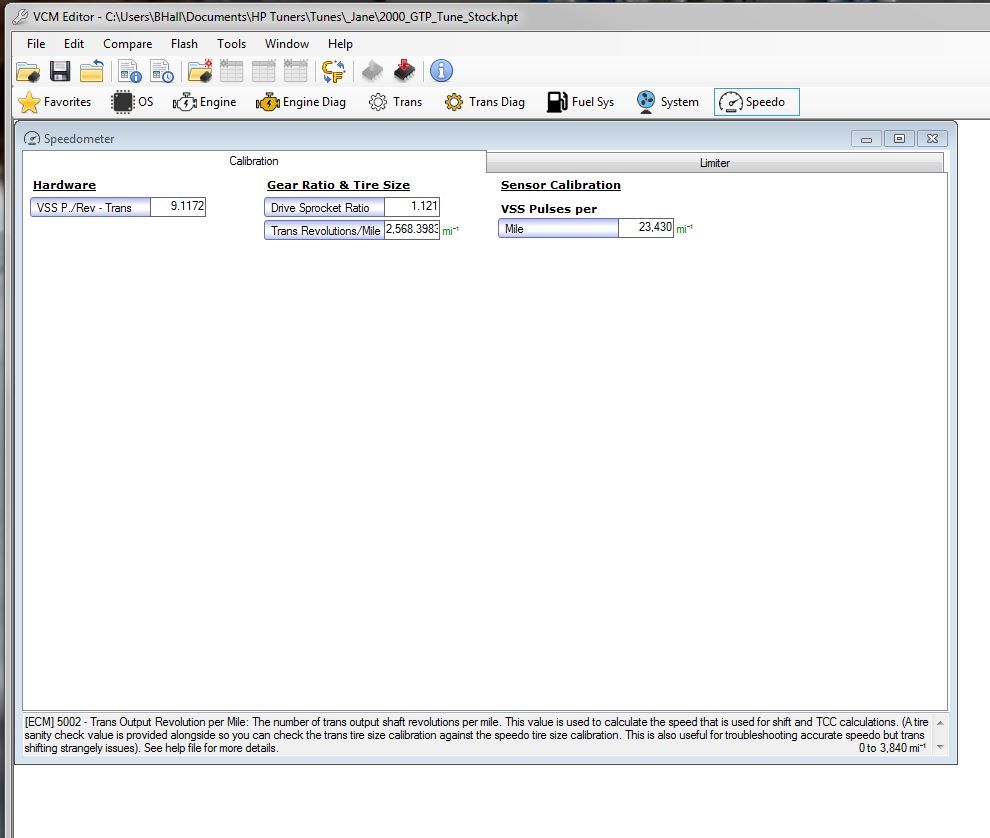

    Here's the settings from my GTP:
  6. #6 Re: Transmission Shifting Hard After Swap
    SE Level Member walkure's Avatar
    Aug 2011
    Puyallup, WA
    58
    That is exactly what I have. I'm starting to think that this spare also has issues.
