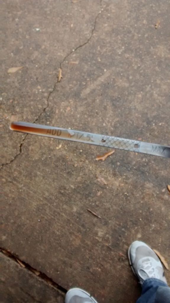

  18. #18 Re: 01 gtp transmission probs
    what does your fluid look like now? is it red to pinkish? or dark? if dark it will smell burnt off the dip stick.
    if you not sure what burnt fluid smells like see what another cars fluid looks and smells like to compare with.
    if your fluids still red to pink, it should be ok.
    when the fluids dark and burnt smelling, the trans is on its way out, its dark cause the fluid is full of clutch material and thats all thats letting it survive. 50/50 shot it lives if burnt up smelling/looking.
  19. #19 Re: 01 gtp transmission probs
    GT Level Member Jaredthefail's Avatar
    Nov 2015
    Olive branch, MS
    300
    Here is a link to the picture of the dipstick. Its a little dark but I think I've seen worse..
    (The picture was too big to post so here is a link)
  20. #20 Re: 01 gtp transmission probs
    that looks fine, drop the pan change the filter. buy walmart tranny fluid on the cheap....its all the same. you'll need up to 8 qts. if they have a 2 gallon jug thats likely cheaper.
