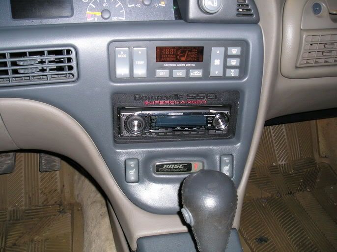

    Jay.. you still need to clean that crud off the shifter.. and get that french fry down under the console.
    Lol ok bill lmao

  5. #25 Re: Where can i wire this to?
    Well.. these items don't just plug in..
    The high power for the actual seat heating.. that would come from a fuse panel and your car wasn't wired for it. The lighting etc, that's also hard wired and not via a connector at this area. So once again you need to tap.
    I totally know what you grabbed and how you did it Jay.. I've done it a number of times myself.
    Here's me fishing the wiring from the driverside seat to the center console
    Adding switches..because there was no option on the 92-99 Bonneville
    When you get it all done and your heater doesn't work, I can even point you to the how to thread about fixing it.
