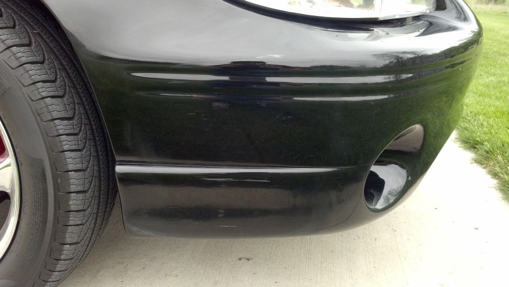

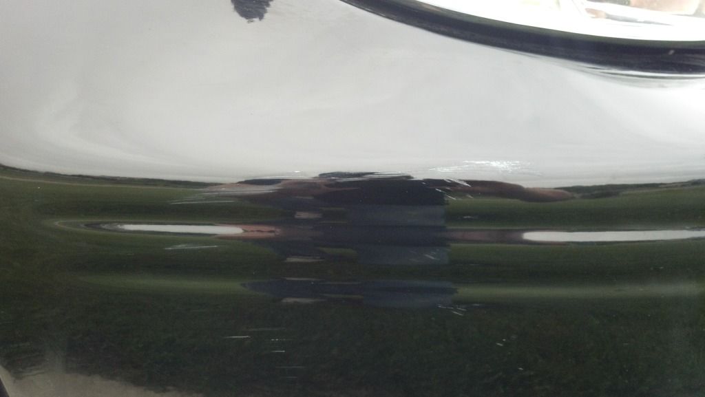

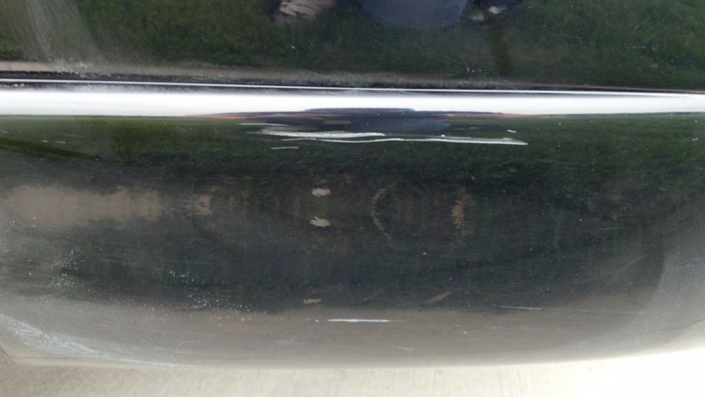

    So just yesterday while i was at work someone hit my car while it was parked. So this gave me the decision to just wax/polish/buff the car.
    Scratches after i tried to clean them up good:

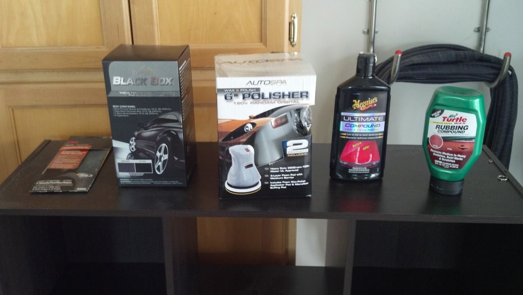

    So then i ran up to the store and bought a 6in buffer with a 7-step black wax kit that includes Wax and Polish. I also have 1000 and 2000 grit wet sandpaper. Plus i have a heavy/medium turtle wax scratch remover and Ultimate compound
    I was thinking i would on monday
    1: Wash car
    2: Use the Turtle Wax or Ultimate Compound over the whole car with buffer to remove scratches
    3: Then use the black wax kit
    Is my thought process correct or should i just skip over the scratch remover/compound over the whole car? my car is filled with tiny scratches in the clear coat and some in the paint.

    I washed clay barred, washed, buffed with ultimate compound, hit the bad spots with scratch x, buffed with polish, then waxed. Turned out really nice.

    Take all that Turtle Wax crap back. If you've never wet sanded, now isn't the time to learn. If i were you, claybar the entire car, get some Mirror Glaze #2, #7, and your choice of topcoat (#26 will work, for instance) and take your time, and go at it. Also, that scratch looks like it's below the paint surface, so you ain't fixin' that with polishes.
    Edit: If you do nothing more than hit it with a cleaner wax, Claybar it first. You'll never get it as slick without the 'bar. It's a 15 minute process.

    just a tip, any scratch that you can feel with your finger nail will not come out, but buffing with compound and swirl remover will get rid of fine scratches and swirl marks.
    that black wax for black cars may help hide deeper scratches.
