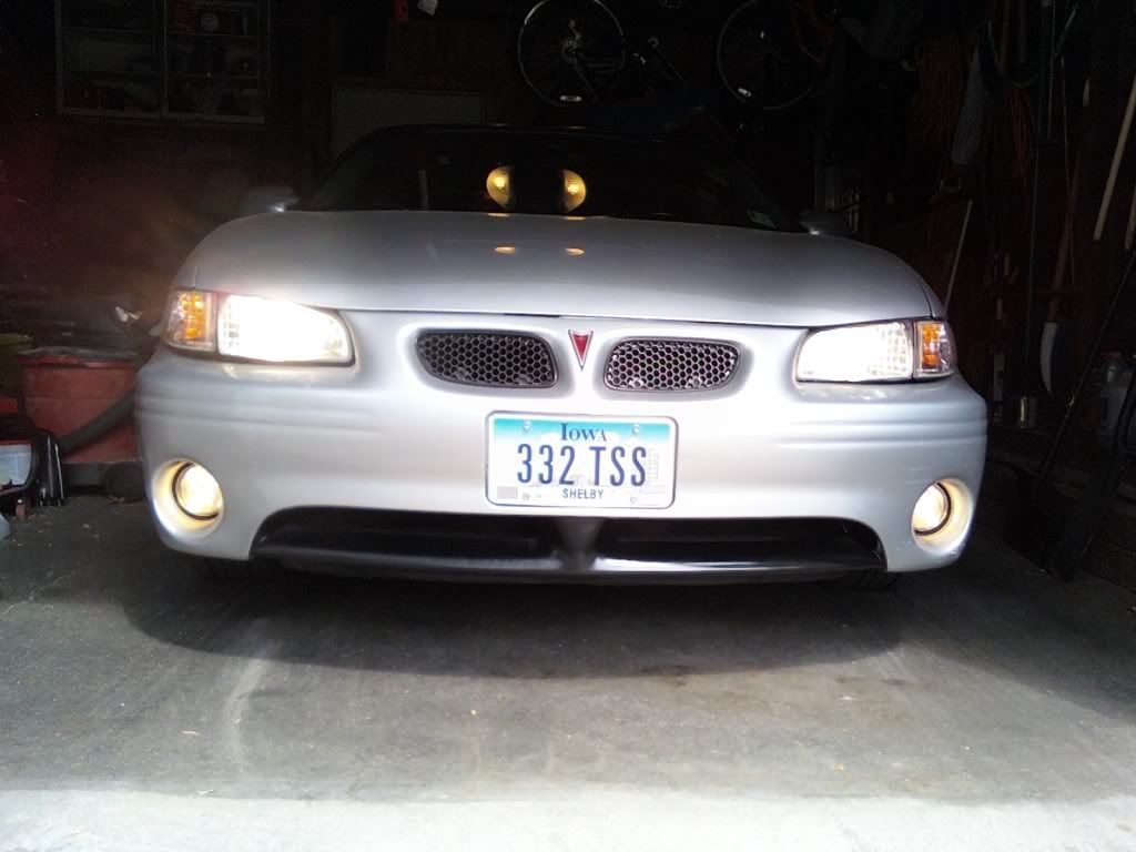

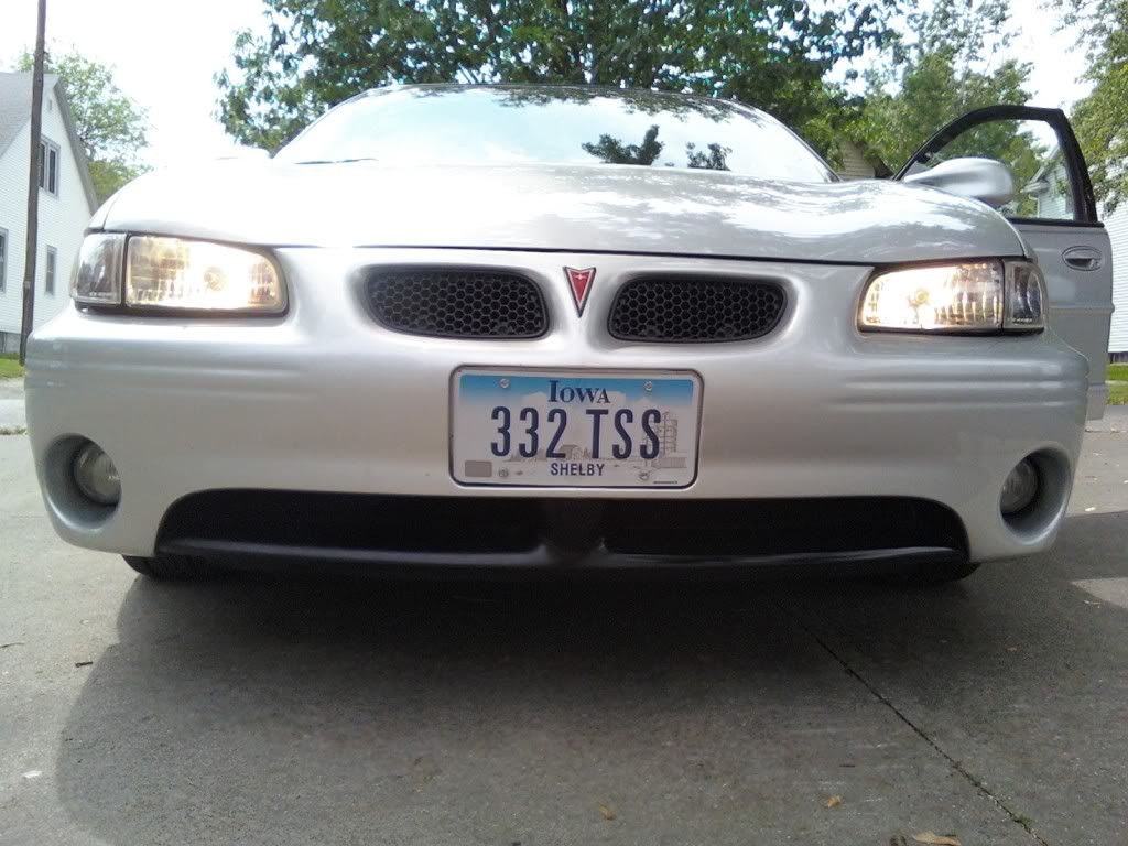

    Im working on uploading some new pics of the car with some fresh paint. let me know what you guys think.

    Aw, that reminds me of our first GP, Silver with the front fascia painted black. It looks good, and very clean too.

    nice so far!

    Looks good.
