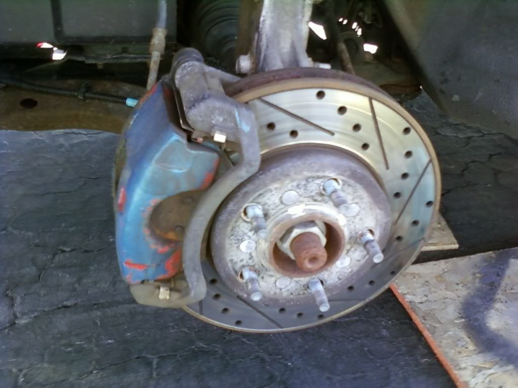

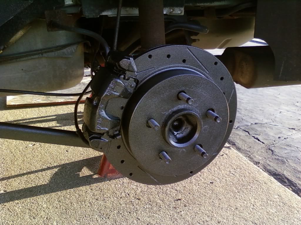

    used a grinder on the bad spots. wire brush for the small spots and primed it, painted with Krylon for Plastics...its heat safe. i taped off the body and basically painted everything. i like the stealth, but you can just tape it off obviously fro specific parts at paint time. 2 coats and i did last fall, lasted fine though the winter, front pass. has a spec of chip other than that, still looks good. i didnt clear coat it though, forgot grrrrr.
    old paint, without any prep after 2 years... young and wasnt thinking, haha
    new paint;fall 09. dont have any recent pics on how its holding up, but try to when i put my summer rims back on.
    ps: windex, is the best pre-adhesive solution. it's not really adhesive, but used that before paint.

    its not the best for the pads, i agree. however the paint will come off the front of the rotor the first time you use them as they heat up so i wasnt about to tape it all off. keep in mind i needed to change my pads, i wouldnt do it if you recently put on new pads. but this was much quicker, AND you dont miss any spots!

    sry, the first picture is before the grinding sand or wirebrush... NO--i would not advice painting over the rust. (the two color paint was when i was young and lazy and dumb, i just primed and painted... hense it chipping off so easy) SAND! SAND! SAND! 1. with out it, it wont stick over time 2. its not the right solution (the rust will still be there) i didnt get a picture of it raw before paint. all the rust was grinded off, and the paint was sanded or wirebrushed to bare steel. then primed twice and painted. and yes rust kills the look of everything. since i have very open rims, it was something i needed to take care of, and get rid of.
