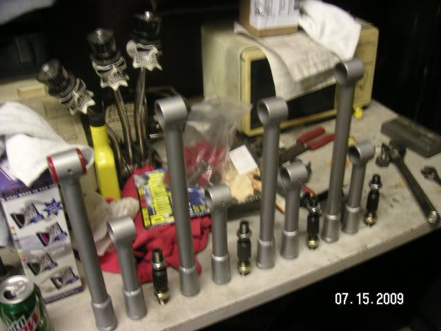

    Waiting to hear back on the GXP rear calipers, and found a great local hardware store that has flange bolts/nuts in larger metric sizes. Here are a few pics in the meantime, at this point I'm painting/detailing more than anything else... Still have to drill out and retap the one trailing arm bracket bolt that broke.
    Here ya go, look ma, no suspension, no brakes.
    Here's a blurry picture of the lateral arms painted, just going with a hammered silver look.

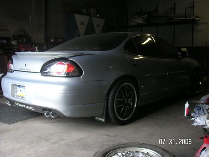

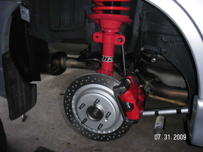

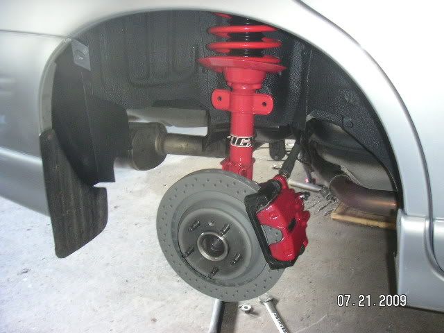

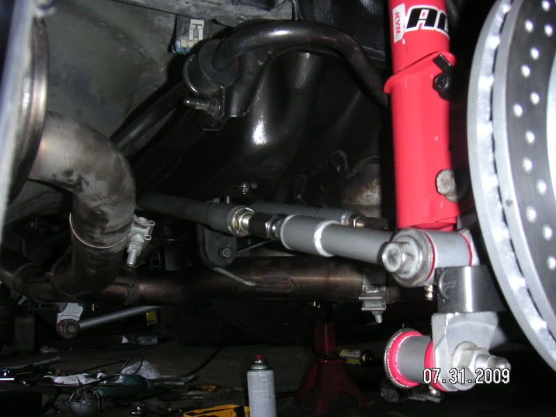

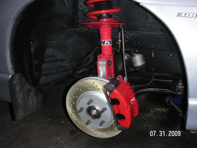

    Almost done with this project, have to grease all the fittings, bleed the brakes, do a really rough alignment to get it there, and hope for the best. Bending the brake lines wasn't too bad, flairing was a PITA, but that was because I got a cheap tool, decided to do inverted flares in combination of the bubbles... Was able to get broken bolt out of trailin arm bracket mount, took about an hour, but got it... Although not done, car is back on the ground, the B&G springs dropped it more than I thought it would...
    Some of these may look like duplicates of past pictures... Passenger side front.
    Driver side front. Painted the caliper brackets gun metal, used G2 caliper paint on the calipers.
    Next couple pictures are of the passenger rear brake/suspension, pretty much done..
    Best picture I could do to get the whole car in it, as it sits is how far it dropped, I didn't even roll it back and forth to get the front to settle yet... The tires do fill the wheel well..
    Last picture just showing the lines comparing tire to quarter panel... 19x8.5 with 38mm offset.
