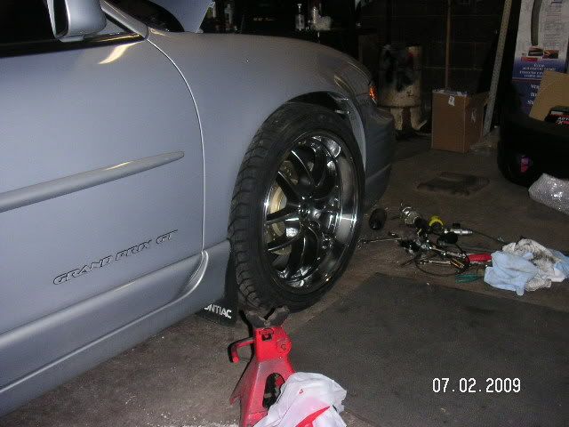

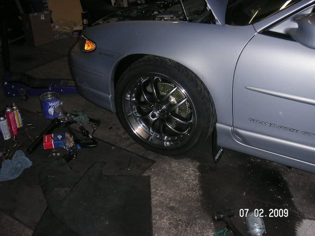

    Well, she's back down on the ground, still have some stuff to take care of. Ordered fittings and brake line from Russell, do not like at all the amount of tension on the brake hoses, so seeing what I can come up with. No clue once it moves if it will drop any further, it's kinda nice the way it is...
    Tire width is huge compared to the stockers, not sure if I expected such a difference.
    The inner well was already sprayed heavy with undercoating, I just used Krylon satin black to just give it some color. Attempted to take some pictures but the lighting and such played havoc with the point and shoot. Here's the only one that really came out. The 19's don't look too bad in person, better than the pic IMO.

    Well, I can do my happy dance now, going to order some G2 caliper paint (black or silver, would go red, but not sure I want to draw attention to the rear caliper or lack there of - but it does stop the car) but the front end is pretty much done. Camber is still off a bit, but the tires did tuck under the fender well after rolling car back and forth a few times.
    Much happier with the brake line (not dot approved though). Used a 10mm-1.0 female x #3 reverse flare up at the hard line, then a 10mm x #3 banjo with a 35 degree bend down at the caliper. Connected the two with a 18" x #3 line. It's not nearly as taunt as the stocker, didn't have to bend any brackets and has a slight cool factor to boot.

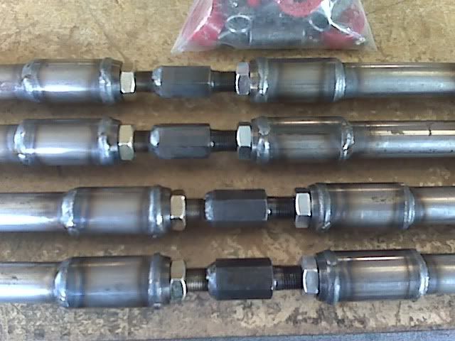

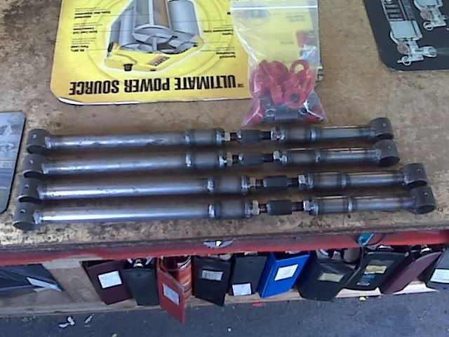

    In the meantime though, I found another source for trailing arms and the lateral rods, ordered a set from HT Motorsports, ordered on Tuesday and they arrived today. I just went with a bare finish, but he does over powdercoating, I'll just end up painting them Hammered Silver. Here are pics of the rods, come with poly bushings and grease fittings to boot.
    Now for the bad , I knew the rear suspension would be a biotch compared to the front. Looked at the bolts for the trailing arm (where it bolts into the cup/bracket), all the bolts well rusted, after hitting them heavy with penetrating oil and letting it soak, decided to take them out. All came loose easy enough, but of course my luck would run out and one bolt broke flush, so now have to drill and retap one, not terribly difficult, but still a pita... I guess if that's all that goes wrong I should consider myself lucky..
    Let's see, need to know what size bolts hold the trailing arm to the spindle... May still be able to get it off, but seems seized to spindle assembly... Dayum, I need some air tools...
