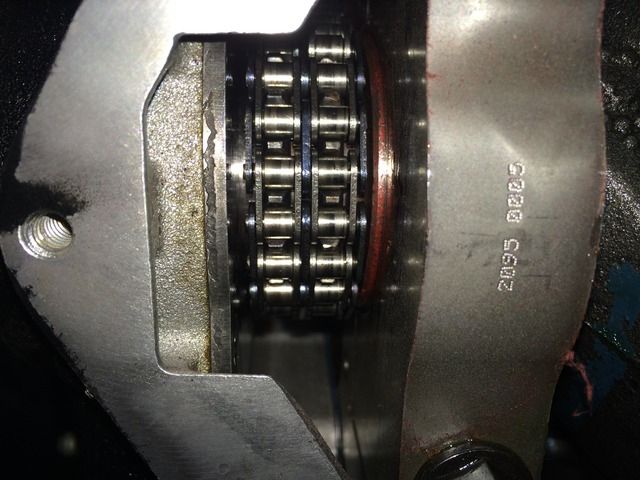

    This is what could happen if you don't machine the gear like it NEEDS to be...The only thing that held it together was the oil pump. I drove it home 40 miles like this, and it's a wonder that I didn't lose an engine. Made a LOT of noise.
    This is with a machined cover, and double gasket. It'll still rub...

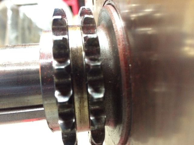

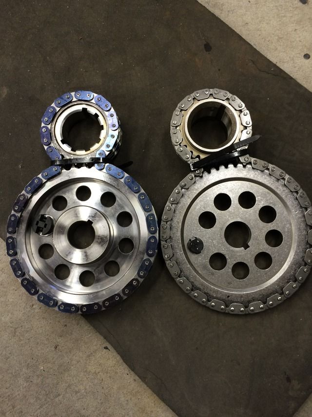

    Here's how mine turned out with 1 metal gasket , 1 surfaced-ground oil pump cover (from gr8racingfool) and machined crank sprocket.
    This appears to me like it sits flush against the crank surface - if the chamfer wasn't correct its my understanding there would be a gap
    Double vs stock
  19. #19 Re: New double roller installed
    Buffalo
    3,868
    Now I noticed the machining isn't as much as the stock one, but they both sit flush .....
