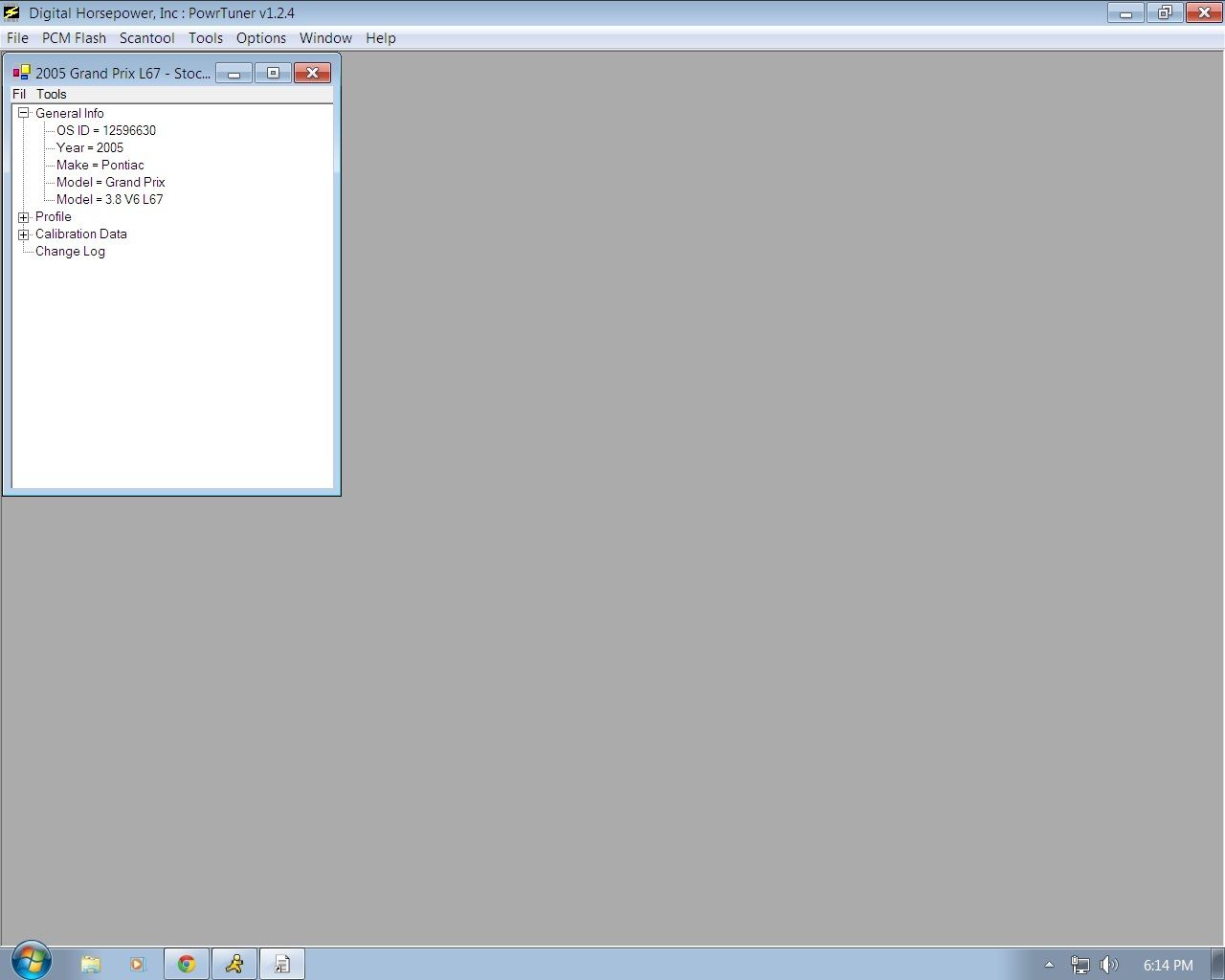

    Quote Originally Posted by ScottyDoggs View Post
    The DVD I got with DHP was pretty much all of Bill's stuff. And that's a 2005 L67, which is series II, where as mine is a L32 series III. Might make a difference but I dunno.
  5. #5 Re: Anyone ever figure out how to unbrick a PCM?
    its just listed as a l67, thats a non issue, its a 05 bin try to flash one. theres the off chance your bin was never mapped by dhp or something like that.
    theres two in there one works, one dont, the other is a comp g bin. once you download one you can see if the osid # match or not. if its different try to flash it.

    Not a single PCM on eBay has an OSID that DHP lists as compatible. The 3 PCMs I got are all literally one number earlier though. Can it make that big of difference?
  7. #7 Re: Anyone ever figure out how to unbrick a PCM?
    i was talking about the bins osid #. its in general when you open a bin to edit it.
